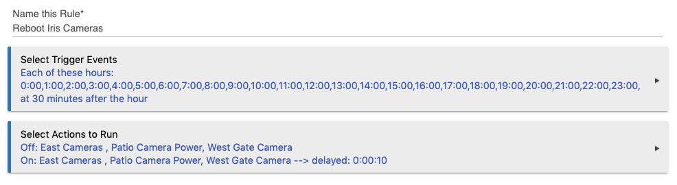

These sound like Iris cameras that you have factory reset. I have 4 of these that are exhibiting the same behavior, but a lot more frequently. I ended up creating a rule to reboot them every hour.
They are. Could you share your rule?
Here you go...
I have all 4 cameras reboot at the same time.
Wow. That's a lot of restarting. I maybe had 3 or 4 in a month lockup out of 14 on average.
They probably don't need to be rebooted that often, but the the lockup was random so it was difficult to determine how often they really needed it. I just decided to do it once an hour and they've been running this way for 6 months now without any issues.
