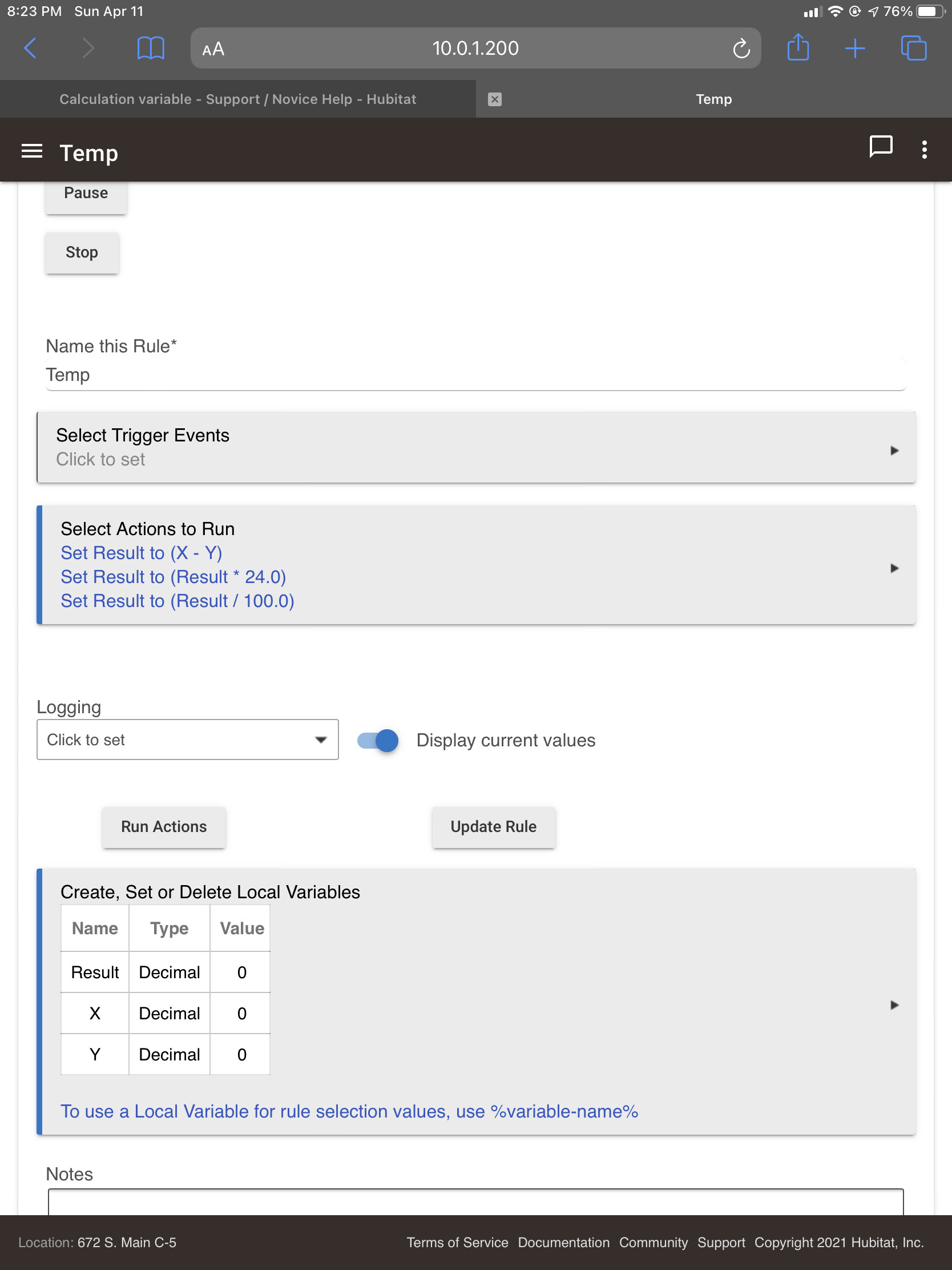

@bravenel , I've been messing around for a lot of today and think I'm making progress with different tests. What i can't work out is how to do variable math with several elements of the formula. I.e i can do one variable minus another variable but that's where it ends. How can I do X-Y *24/100 for example. Any screenshots would be appreciated. However, slowly moving in the right direction and appreciate your support :+1:
You have to use temp variables at each intermediate stage.
Brilliant, that makes such sense and i've tested it. Its flawless! ok, for the next steps now....Thanks Again :slight_smile:
