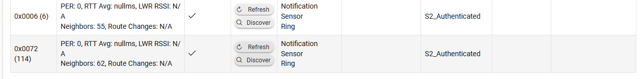

I have two Ghost devices (they are apparently failed Ring Alarm Contact G2 devices that I later got included properly):
I cannot get them removed (neither Refresh nor Discover do anything). I tried my USB Stick and they don't show up as "Failed" and the "IsFailed" button runs for a while and doesn't allow me to "Remove Failed" either.
Yep, I've powered off/waited/powered back on. Can't get them out.

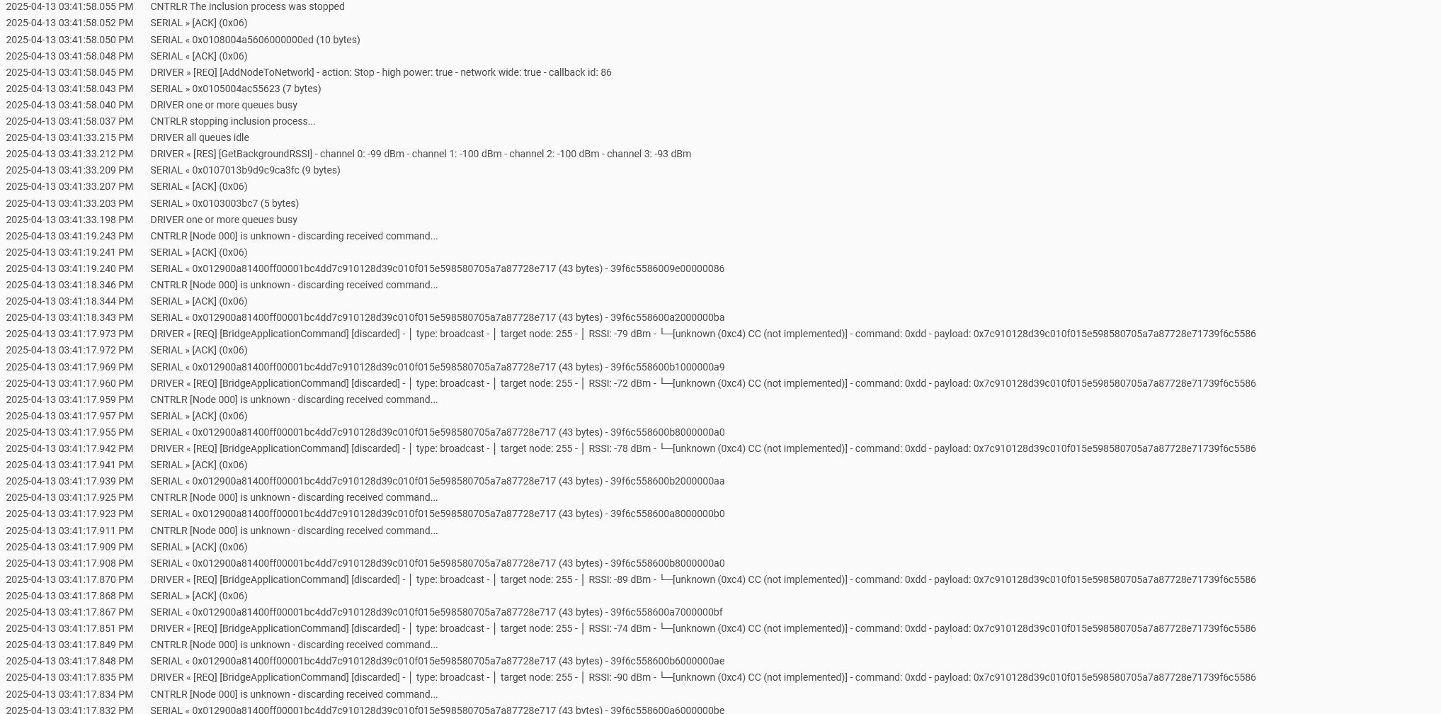

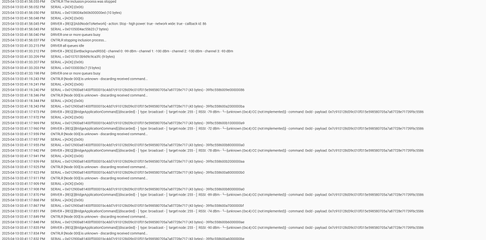

I still can't get that Ring Range Extender Gen 2 to include.
Here's the ZWave log (part of it from the end of the inclusion):
The hub log only shows:
I've tried factory resetting the device many, many times. The hub just doesn't recognize it.

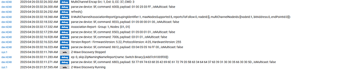

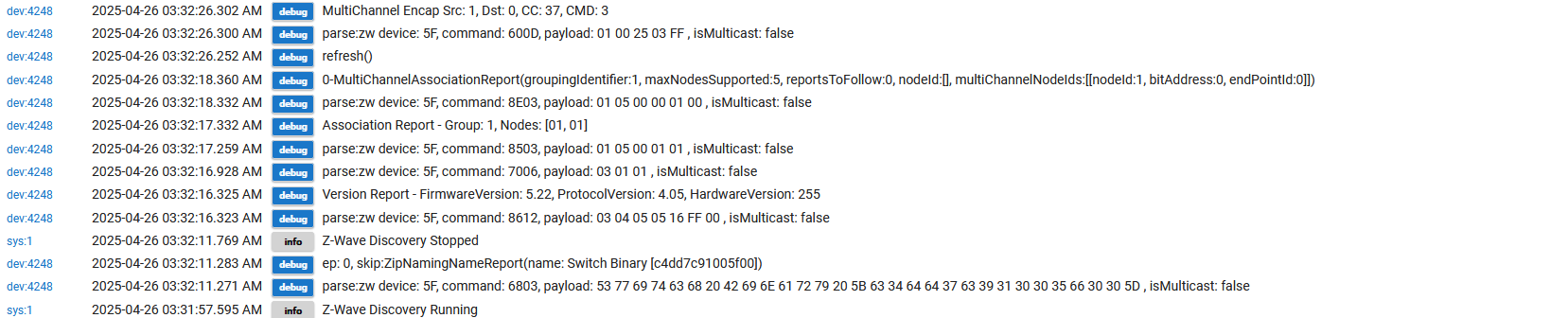

While it SEEMED to find & pair it, it actually seems to have CLOBBERED an existing device (one that was paired on the hub LONG before ZWJS and one that had ported to ZWJS without a problem).
The nodeid it seemed to choose was 5F --and that was my "Family Room Dual Outlet Switch". Here's the log:
As you can see, it thought it was pairing device 5F.
My first clue that something was wrong was when it said it "found a device" then told me to pick a name for my "Family Room Dual Outlet Switch" (using the "Device Name" from the pre-existing 5F).
When I opened the device details, sure enough, it was nodeid 5F with "Family Room Dual Outlet Switch" in the Device Name field and my new name in the "Device Label". It still had the "Jasco Z-Wave Dual Outlet" Type (driver).
Oddly, the Dual Outlet switch DOES seem to work still and it still shows up as a "SPECIFIC_TYPE POWER_SWITCH_BINARY" (which is how my dual outlets all show up).
And, I don't see the repeater anywhere.

This is definitely a bug when switching from JS back to ZIP @bcopeland
Have seen it more than once now, probably repeatable if you include something in JS and switch back to ZIP afterwards. Then try to include more devices.
In my case, the clobbered device was included years ago on the legacy z-wave.
