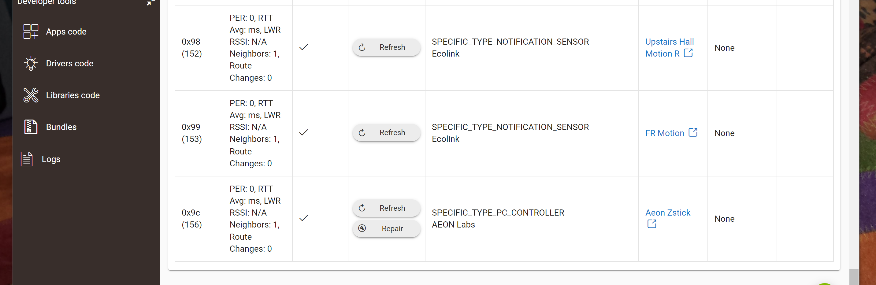

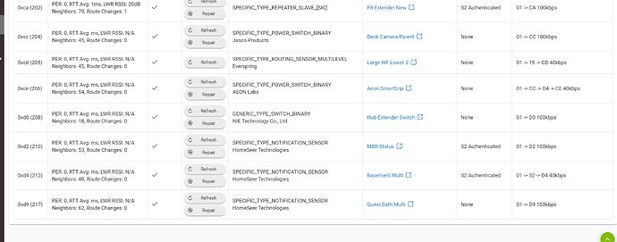

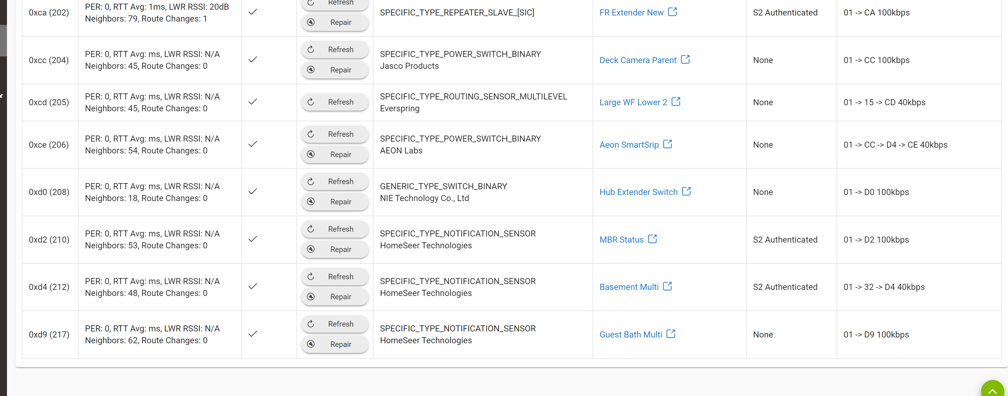

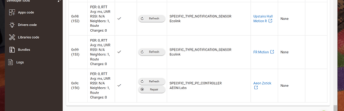

C8 to c8 pro migration failed.. sucessfull after a few various tries
No errors said migration was fine.. but most zwave devices were missing.. old count went up to dxxx
ne2 didnt even get device ids into the A's
And of the devices that were there only about 5 had routes..
zigbee seemed to be there and ok..
old zwave end of table
new c8 pro zwave end of table..
