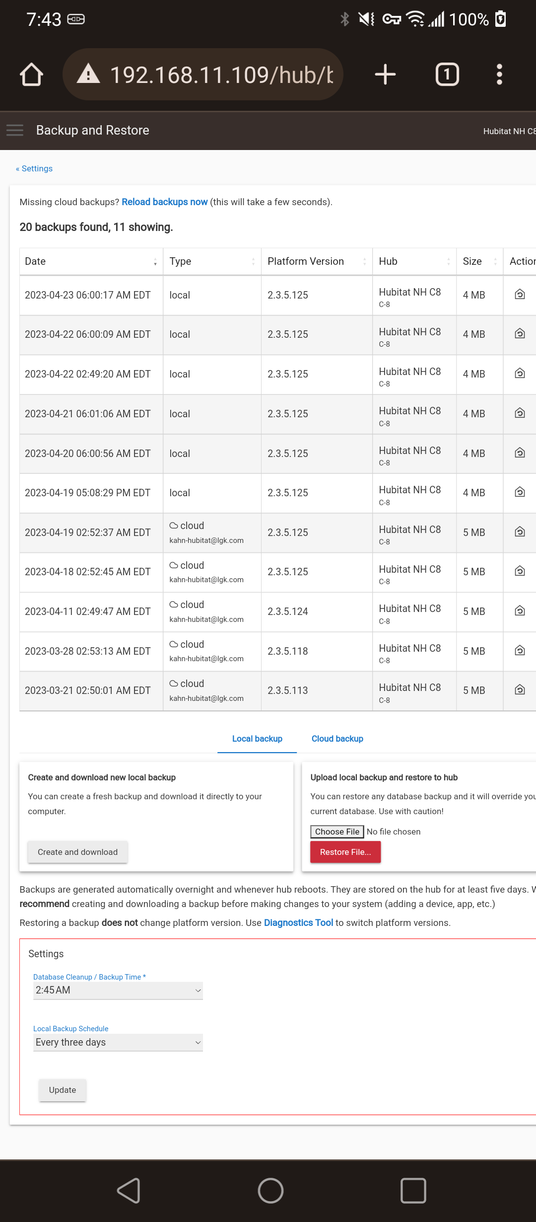

After my 6 am backup

It might be informative to disable local backup for a day or two.

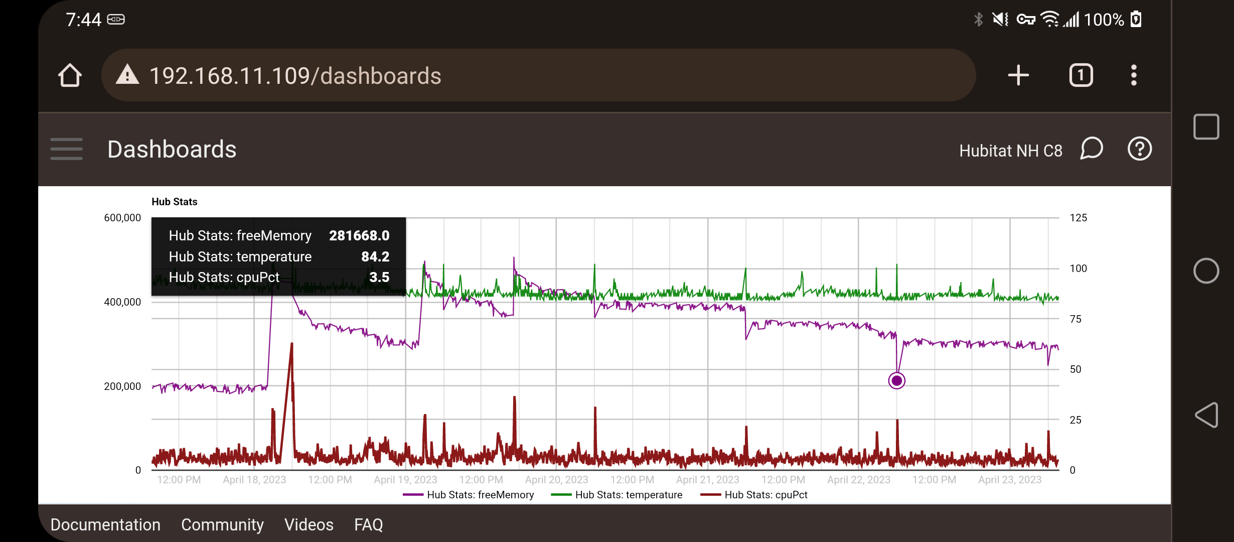

Did anything special occur at the April 18th backup? It looks like after the April 18th backup at the backup time the free memory has a downward trend suggesting it levels off at 200,000 the might jump back up to > 400k. Can you tell if this cycle repeats?

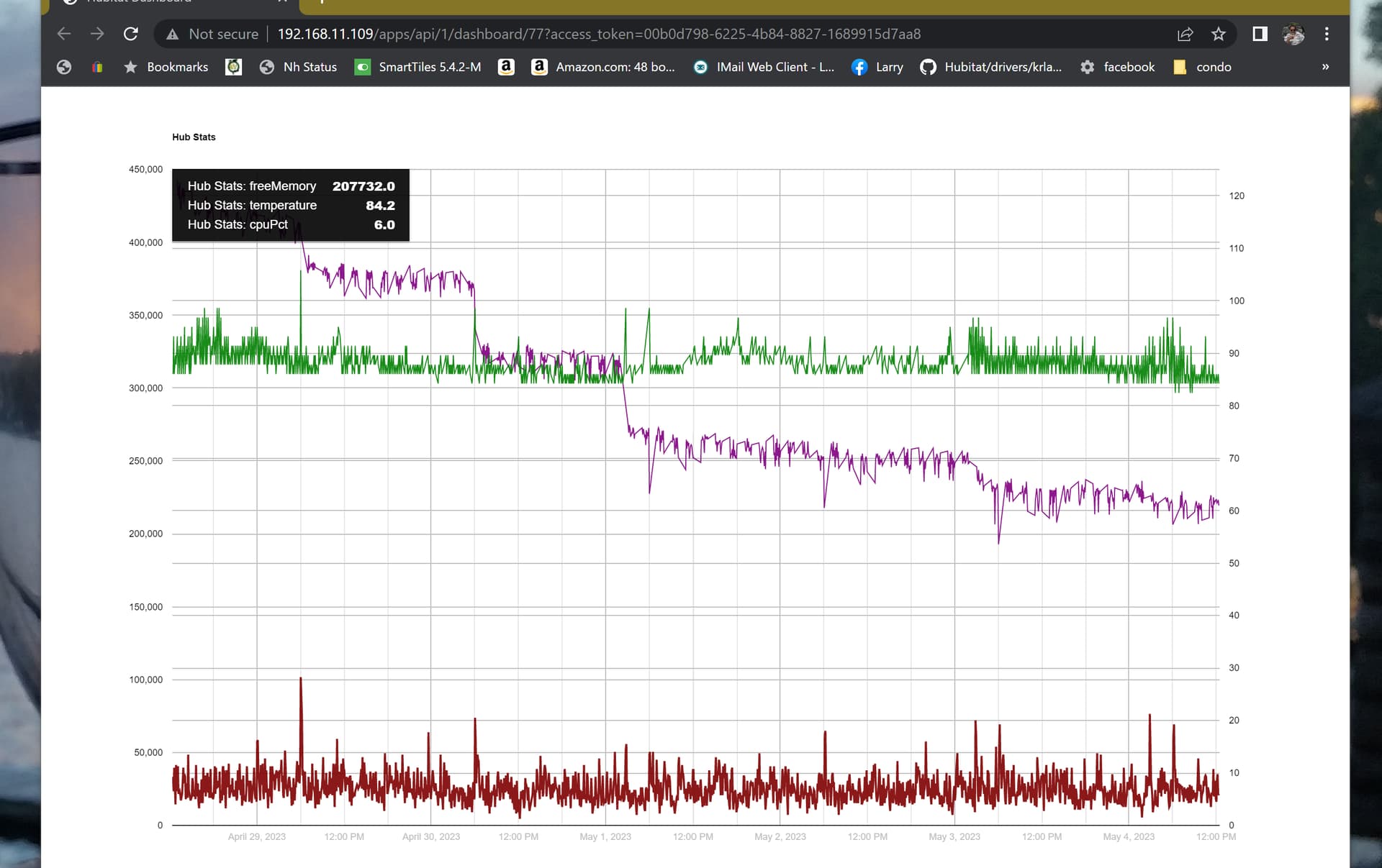

Just referencing the last 3 days you can see the regular drop
.ignore the earlier ones. Hub spontaneously rebooted so i restored a backup just in case anything was corrupted. It does NOT jump back up
It IS loosing memory every night at 6 am backup

as noted dropping memory after a local backup every night. see graph for 6 am backup
