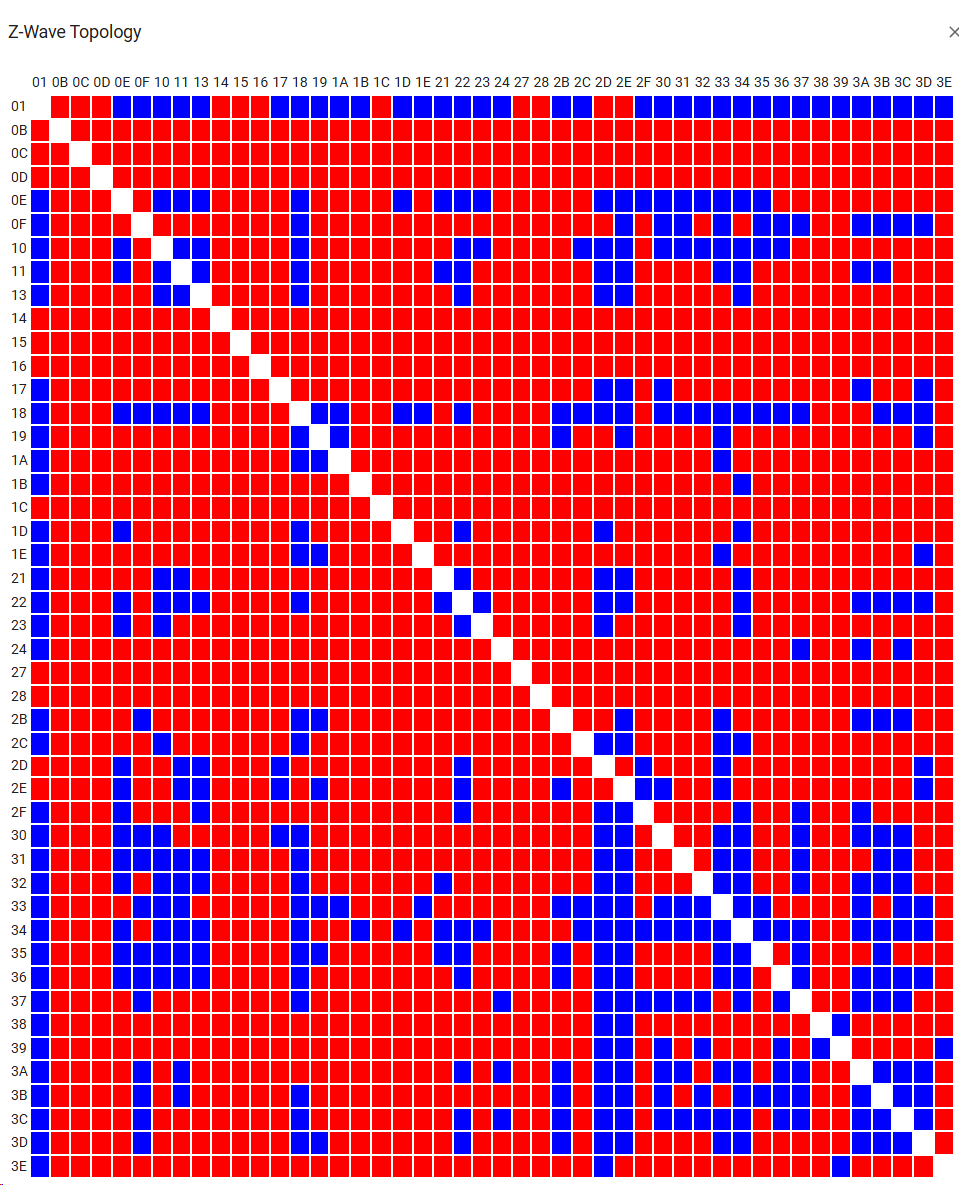

Run this endpoint (put it in your browser address bar and hit enter - you'll get a simple "Done" response after a few moments):
  • yourHubIPAddressHere/hub/zwaveNodeDetailGet
That should fill in the Stats info on your Z-Wave Details page. Looking at info in the Stats column, where you have high Route Changes, high RTT, or low RSSI.
Then post screen shot(s) of your Z-Wave Details pages and your Z-Wave Topology.
Topology is accessed from the Z-Wave Details page:

Thanks for taking a look! Here are the screenshots. Let me know if I missed something.
0x0038 might be a problem. At a minimum it doesn't look like it's completed the pairing process.

I'd guess the one immediately below it but one never knows. Could try removing the power to the one below it and see if it allows you to remove 0x0038.

If you can't remove it in the interface you will need a z-wave stick paired as a secondary controller to remove it.
With the USB method, I was able to remove it finally. Frustrating that things are never so simple. Between that and the replacement hub coming in a few days, I have high hopes for stability. We'll see.
