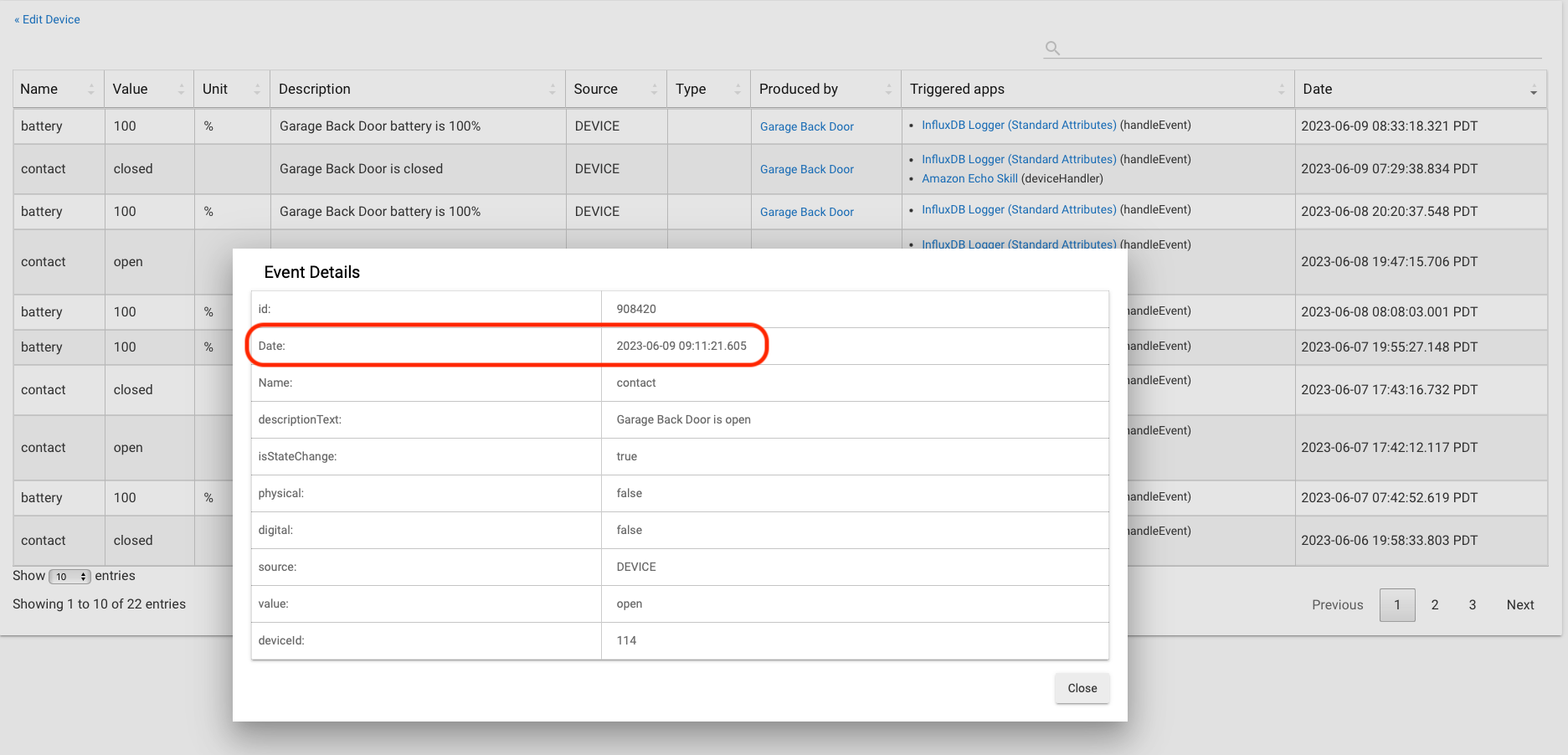

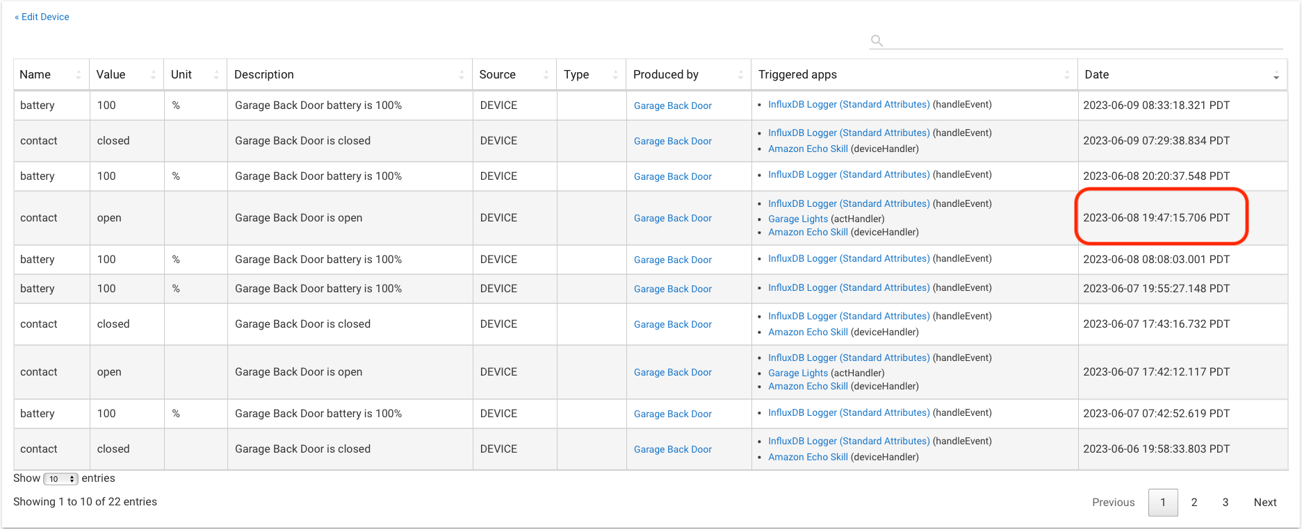

Also, when I click on the device (Back door sensor) open event, the date it shows in the pop up details is not the same as in the Events table. Attached are SS of that...
In your second screenshot, it looks like that is showing the current time in the popup rather than the actual event time. Tagging @gopher.ny to take a look at that. (This is on the "Events" page for device, clicking the "Date" column text, in case it's not clear.)
