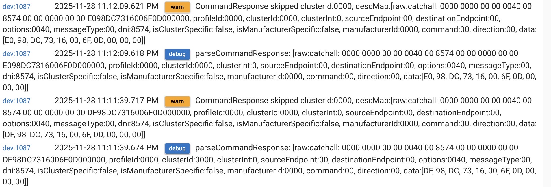

  • When checking my hub logs I noticed my Zigbee smart deadbolt door locks had recently started spewing “catchall” warning messages.

Why it happened
Your failing Zigbee lock had been blasting malformed catchall frames. That can push the coordinator into a “stuck outbound state.” Think of it like:
  • It was waiting to ACK a frame that wasn’t valid
  • It never got a response
  • So it stopped accepting new outbound frames
  • But inbound still processed normally
This is classic TX-only failure on Ember Zigbee radios.
