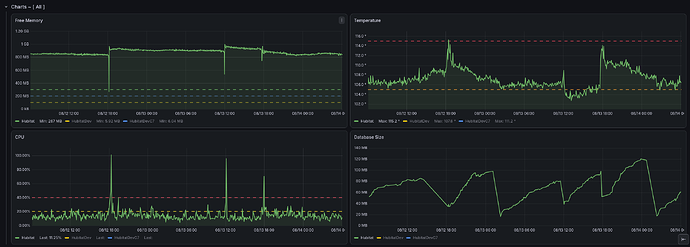

I agree the tools are somewhat lacking to understand cpu load. There is allot that the current tools just don't capture.That said what I do is use HubInfo driver from @thebearmay, my Live logger influxdb syslog driver to export the logs to Influxdb, Influxdb, and grafana.
It isn't perfect but it doe give you a clue when it is occuring and a better chance of seeing something happen
In Grafana i use a Dasbhoard that @jtp10181 created and it this it the lower part of it. This information can be super important to understand the trends of how your hub is going. This is my last 48 hours. All looks good and you can see the reboots for new betas with momentary spikes lof the CPU load

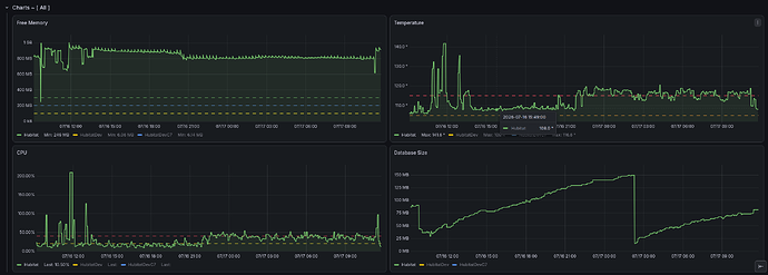

Here are the graphs when i was testing the RTSP streams in beta. You can see the Temps and then CPU load very high in the beginning of these graphs. That was when i had all of my camears connected with High resolution streams. It actually caused High load and a triggered a reboot from it getting to hot. The second half of this graph was using low res streams on the same cameras i could adjust.
