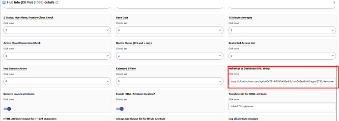

I think I have found the app making the request:
Also, I think I have an old/outdated link below as well, my IP's are now 192.168.1.xx (not relating to cloud request):
