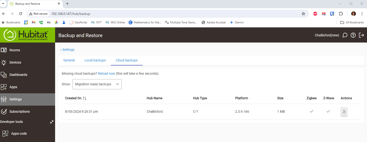

The attached image shows the cloud migration C7 backup I restored to the C8 Pro. Note that both the Zigbee and Z-Wave boxes are checked and the C7 platform, 2.3.9.166, matches the current up-to-date version.
I also repeated the migration process with identical result when the first attempt failed. I created a second cloud backup on the C7, soft reset the C8 Pro, and restored the second cloud backup to the C8 Pro. Nothing changed.
