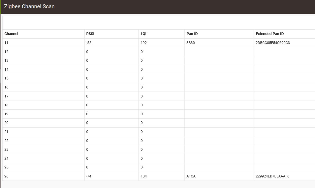

I'm probably not the first to notice this, but I must not have good searching skills. I have a multi-hub setup. Zigbee is turned off on 2/3 of my Hubs.
C-7 - Off
C-8 - On
C-8 Pro - Off
The C-7 had been set to channel 26, but then was turned off. The C-8-Pro was set to channel 11, but then turned off. When I run a Channel scan on the C-8 (my actual Zigbee Controller), it *usually still sees the C-7's disabled signal and *always sees the C-8 Pro's disabled signal.
Further history: The C-8 Pro had been migrated from the C-8, including the Zigbee devices, but then all of the Zigbee devices removed from the C-8 Pro.
Is this a bug? Has it always been this way?

I read on another post that when you disable it, really it just detaches it from the hub platform but the radio never actually shuts off. I am sure someone else can confirm this.
Yes, AFAIK that's why we have to power down/unplug the hubs to clear the radio, they are kind of "always on" even when "off."
Also important, the Zigbee channel scan is known to show old/conflicting data, and sometimes no data at all.
Correct. This question comes up once in a while (I asked it four years ago back when the C-7 was new) and AFAIK has never been answered by Hubitat staff, although by now it's no longer a mystery: there's no setting that turns off the hub's Zigbee radio.
'Disabling Zigbee' evidently stops the hub from processing Zigbee messages (disabling the application layer) but has no effect on its radio or at the Zigbee link layer.
