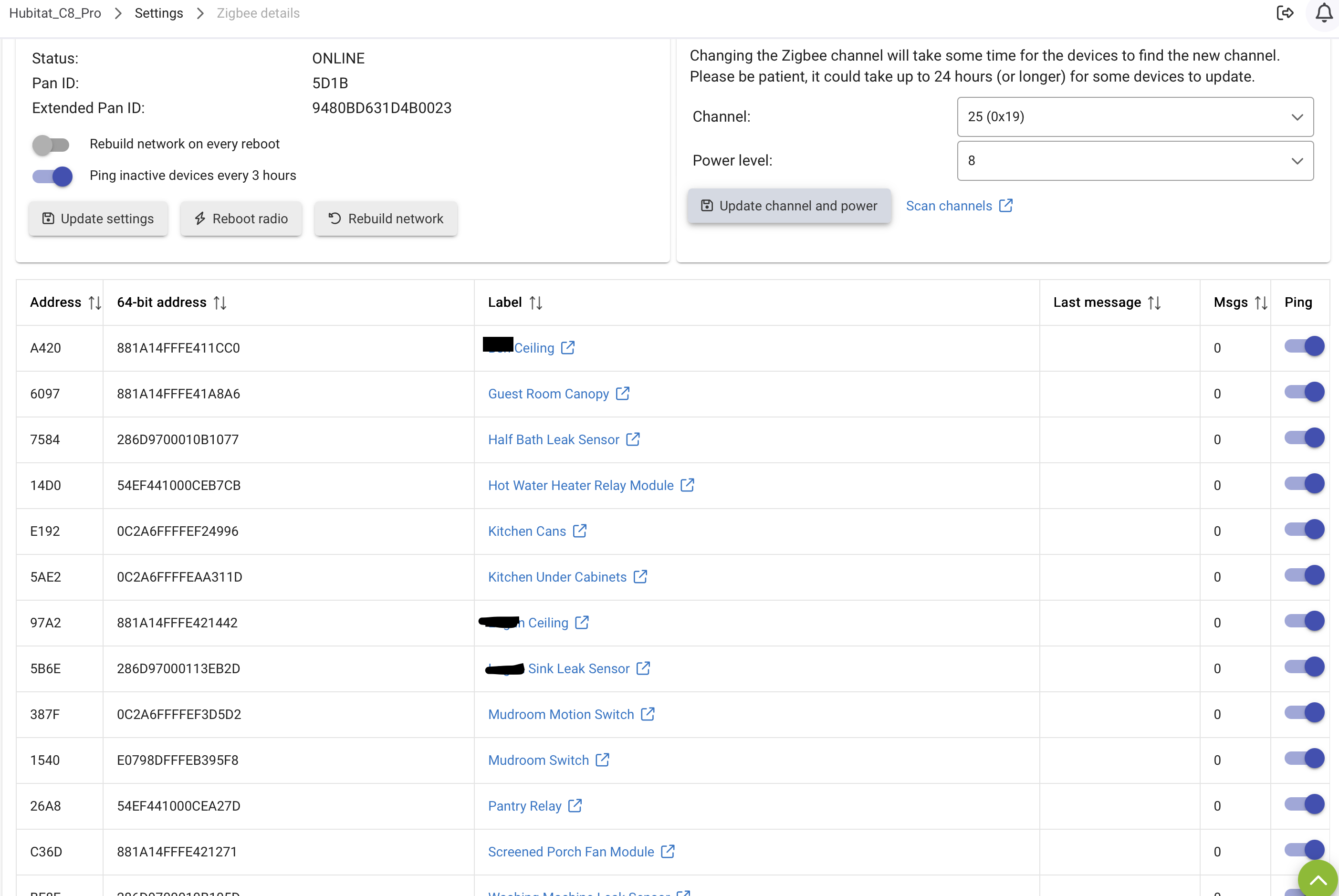

Most recently, all of my devices that are connected via Zigbee stopped working as of 2 days ago. There were no new devices added to my hubitat, and every device stopped working (various brands of switches, sensors, and bulbs).
When I go into the settings for Zigbee, it shows the last message for all devices to be the moment that things stopped.

Since the shutdown, the last message for all devices shows as blank with no last time or messages. Even when I go into the device graph, no devices are shown except for the hub.
I've tried to reset a device and reconnect it to the hub, but the hub does not show the device during pairing mode.
Also, when I click Zigbee scan channel, nothing comes up.

No recent wifi changes. After seeing those posts, I saw that my wifi was set to Auto, so I switched to fixed Channel 1. And switched zigbee to 25. Waiting to see if that fixes it. No change yet, though, and no messages showing up, but I'm being patient (like the settings page tells me to), by figuring out what the next step might be if this doesn't work....
I do have a Hue bridge, though, that I just noticed is also on Channel 25. Guessing I will need to change the Hue bridge's channel, but I won't be able to do that until the morning since you have to turn all bulbs on to do it.
