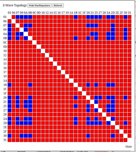

I'm seeing that as far as I can tell, all my devices are functional. However, they don't seem to be seeing each other. I looked in my settings and it's set to LR but I don't have any LR devices. Should I change this? What if I want to add LR devices later?
I look at my topology and it's completely red.
C8, same fw
I'm now mostly LR, but still have a fair amount of mesh.

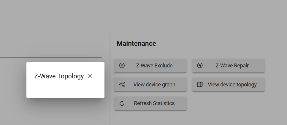

This is what I get when I hit 'topology' just now:
Try using http://<Hub IP Addr>/hub/zwaveNodeDetailGet and then go back to your Zwave Details page
Thank you, EndPoint Master!

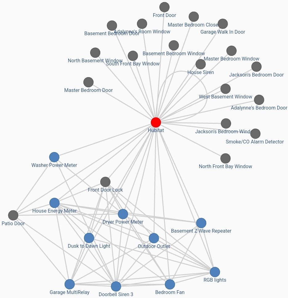

I did that and it's improving. I do have this strange loop on my graph.

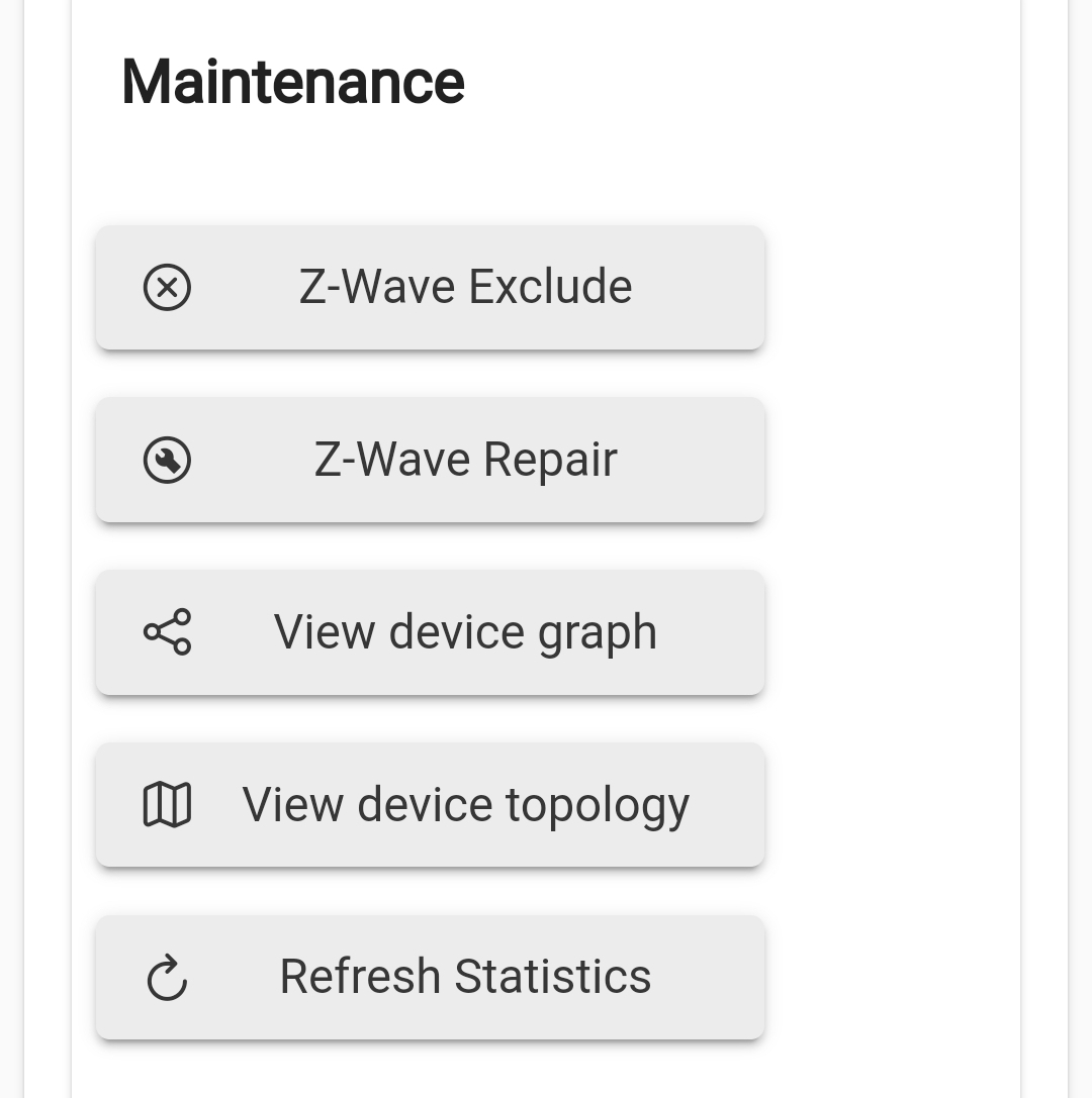

Bryan is recommending using the "Refresh Statistics" button on the Z-Wave Details page when I talked to him about the endpoint recently.

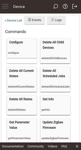

Another thing I found, it's got this weird device that seems to have been created.

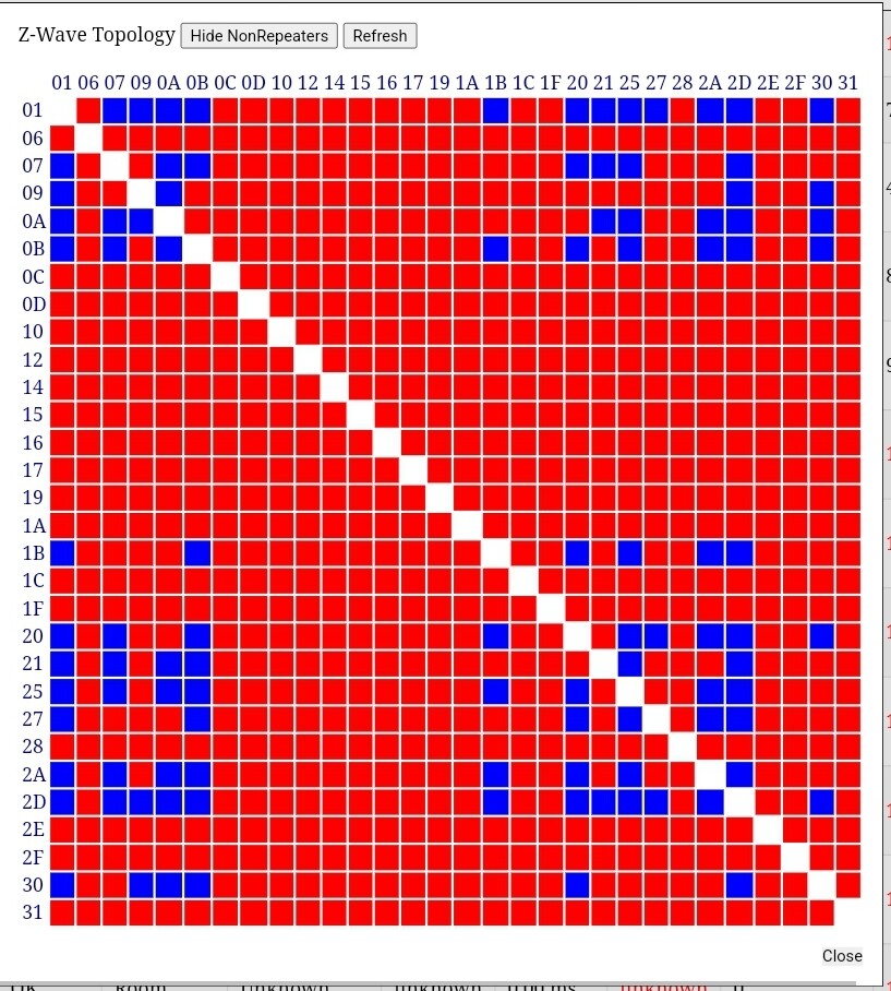

Here is my topology. Again, everything seems to be working.

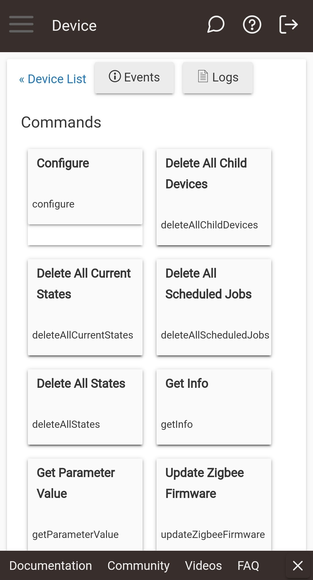

Those are the options for a device when it has plain "Device" selected as the driver.
But the thing is, the hub seems to have created the device itself. It shows up as zwave.

By this, do you mean it shows up on your Z-Wave Details page?
Can you post a screenshot of this device's own Details page? There may be more clues there about what it actually is.
I've never heard of the hub creating a device out of the blue.
Yeah, about that. It's gone now.
What. Is. Going. On?!
IIRC, if you pair a device to the hub that it doesn't recognize, it could join as Device Type "Device." You can then choose the appropriate device type/driver manually via the Device Type drop-down.

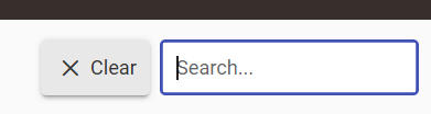

It going away on its own is pretty not normal, to say the least. Any chance you may have changed the device type using the drop-down? Is your Device tab being filtered in any way - to make sure the Search field is empty and doesn't have anything, even a space in it, hit the Clear button next to it:

Did you try the Refresh Statistics button?
Yes I did a refresh. I even went around and activated everything to make it "talk".
