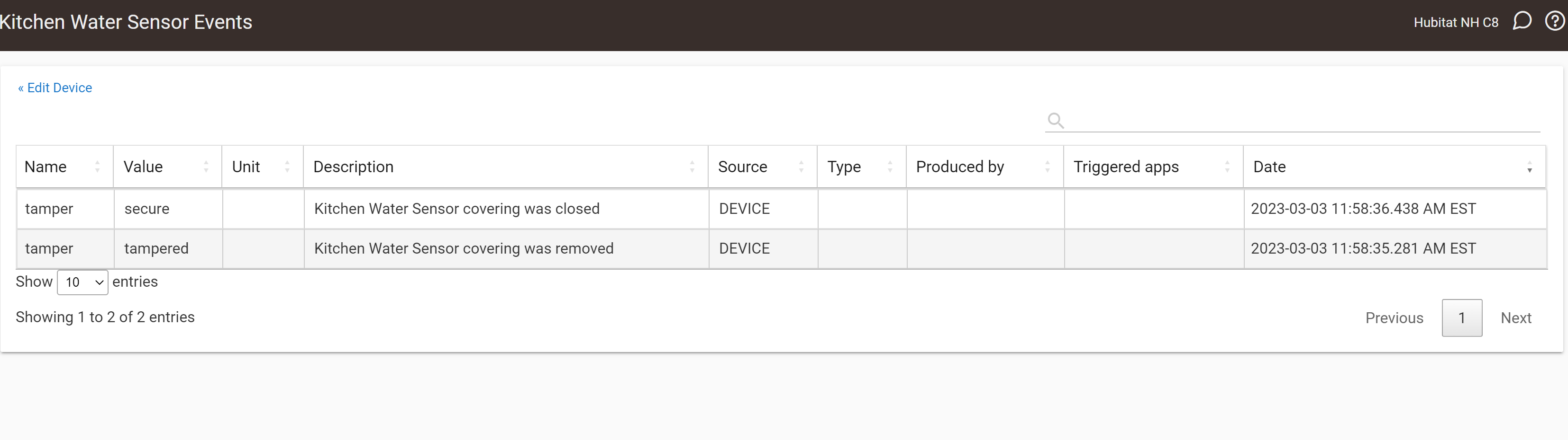

is there a reason with the c8 that these are taking a long time to populate a route?.. Even after forcing an event by opening closing cover etc. The route is not showing in the zwave details..
ie.
ie.
