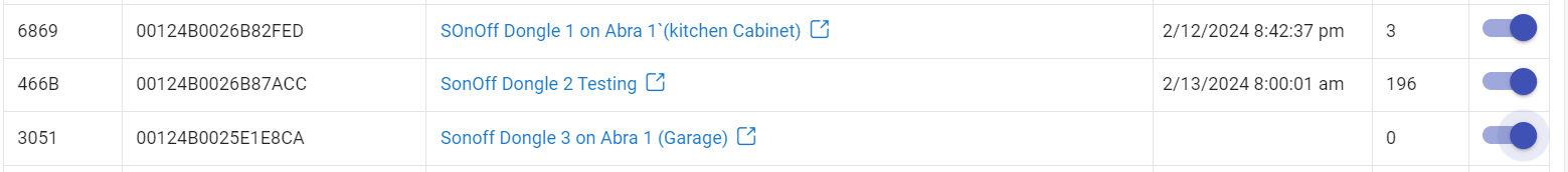

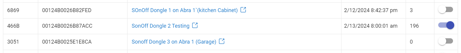

Enable ping on two devices. Save the setting, and after confirming the save, the Ping settings are reversed back to original.
Original:
Updated:

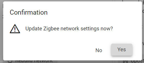

Save the change:
2024-02-13 08_18_46-Hubs, Network, & Tech
2024-02-13 08_11_25-Hubs, Network, & Tech
After confirming save, Ping settings go back to original:
