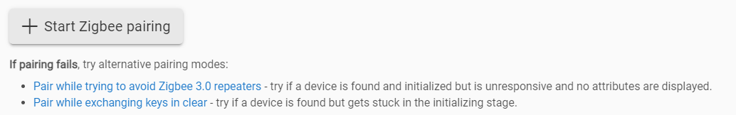

Devices that aren’t on the list can be very inconsistent, so the behaviour you are seeing is not unusual in that case. There are a couple of other options available for pairing Zigbee on the C-8. See if one of them helps.
Another thing that may help is using the “Reboot Radio” and/or the “Rebuild Network” commands from the Settings -> Zigbee Details menu before trying to pair the next device.
If you do use the "Rebuild network" command it's a good idea to follow it w/the "Reboot Radio" command.
The two options that Sebastien is referring to are on the Zigbee pairing screen, alway do a reset on the Zigbee device before you try to pair it.
