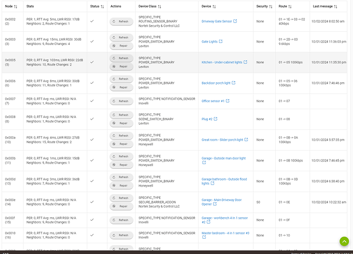

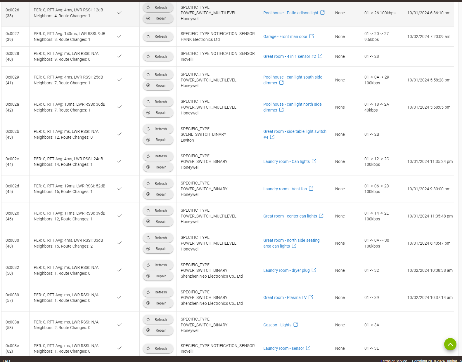

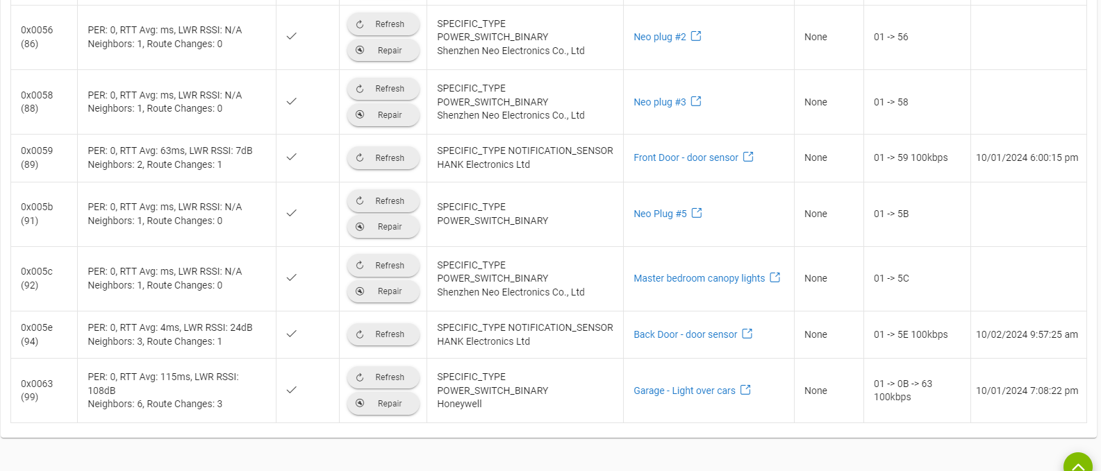

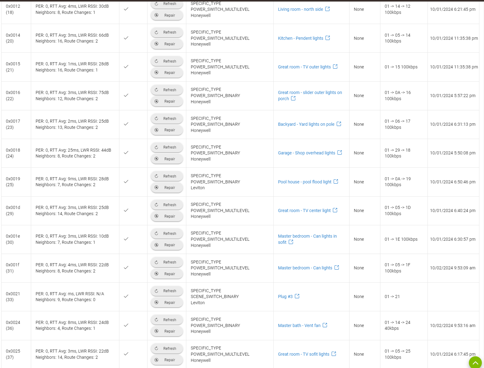

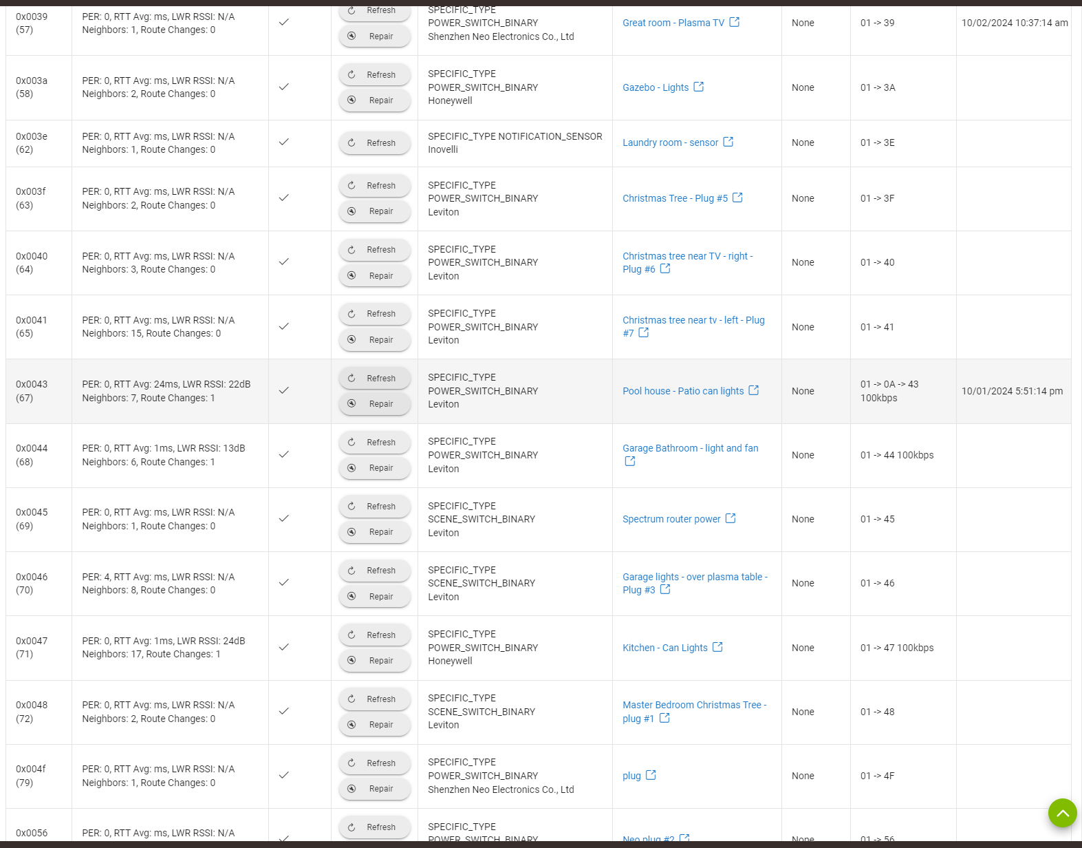

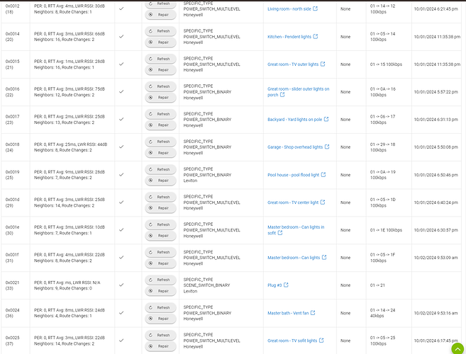

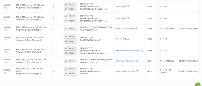

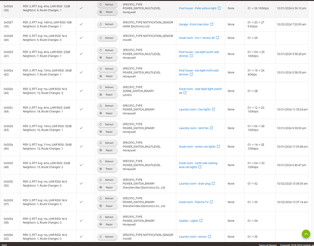

I see the troubleshooting assistance requests a bunch of screenshots. Here is the info as of today.
Z-Wave details:

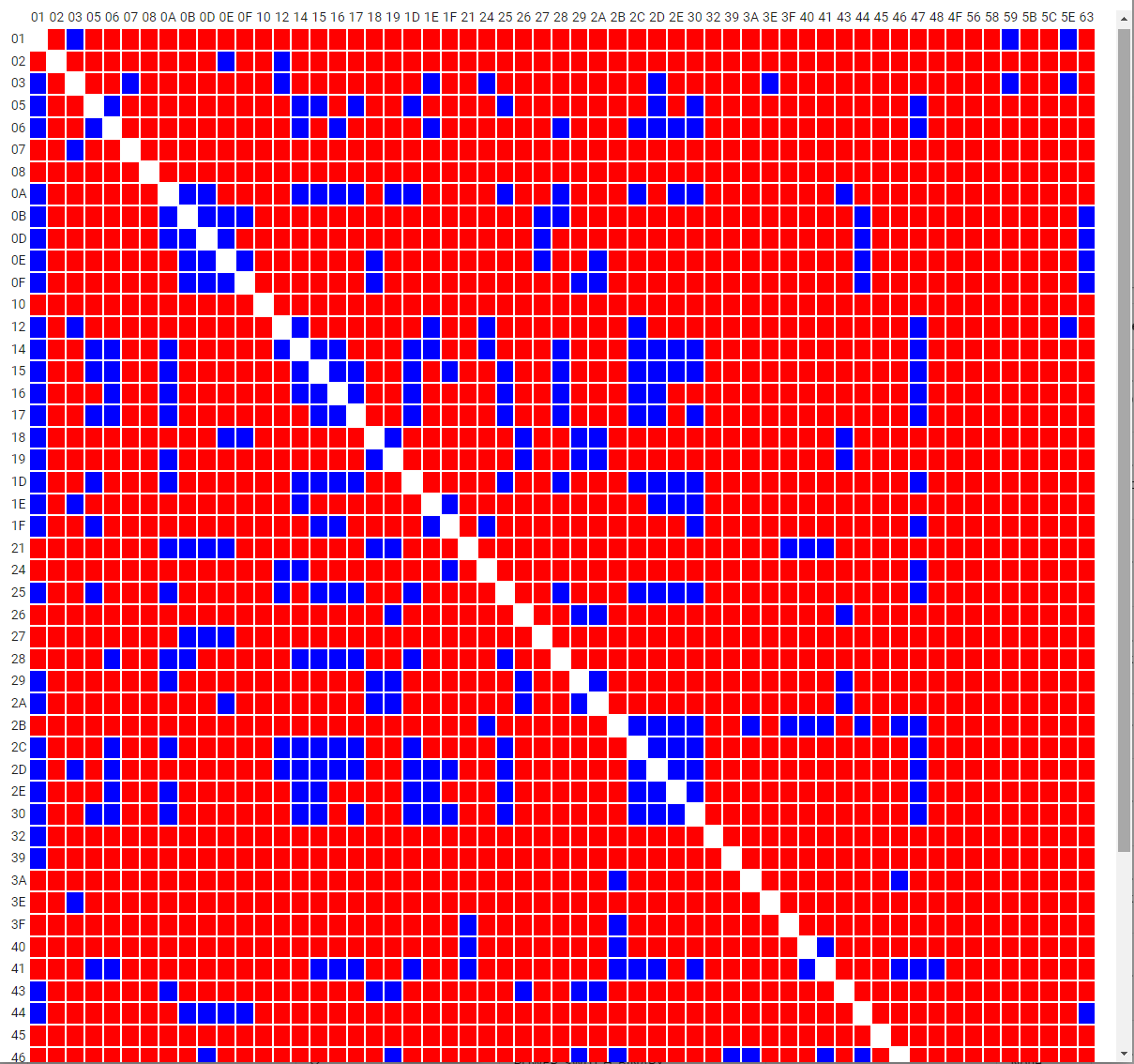

Z-Wave topology:
The red and blue map shows a lot. The top horizontal row should be mostly blue.

Why is that the desired state? The first column for the hub is mostly blue now. The horizontal hub line (first row) remains mostly red. It's not clear to me how to read this chart and I didn't find any documentation about the chart either. I don't yet understand what optimal would/should look like and why.

  • Rechecked the topology map and the first column has the most blue hub connections

First column or first row? or both? Ideally both should be nearly all blue. That map is the neighbor map, so if 01 is Red that means the hub or device thinks they are out of range of each other. I think the top row is if the hub sees the device as a "neighbor" and the column is if the device sees the hub as a neighbor.
