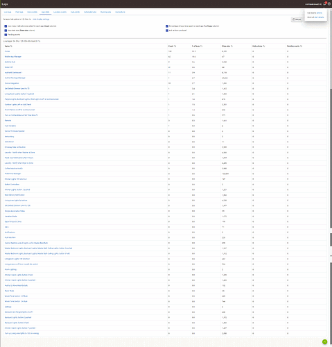

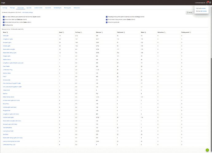

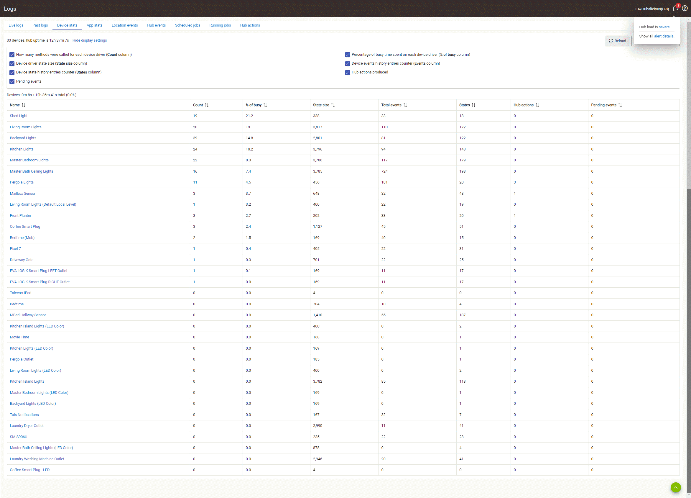

  3. Deactivated Apps that had a high busy % (Primarily apps that monitor power usage for notifications)
  4. Deactivated Devices that report power usage
  5. Removed all devices from Maker API
  6. Logged out and back in on my mobile devices. I tried this because the Mobile App Manager was at some point running at over 30% usage in the App Stats
