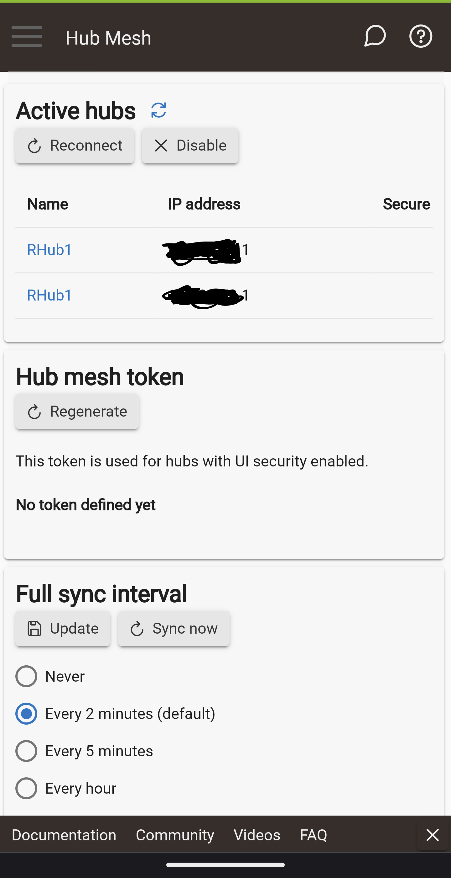

The first issue is that I now show two hubs with the same name in the list of meshed hubs on RHub2 (the list shows "RHub1" and "RHub1").

Any ideas how to clean up the duplicate hubs (the "old" C7 RHub1 and the "new" C8 RHub1 both seem to be meshed with RHub2)--and how to fix that device that isn't staying properly mapped?

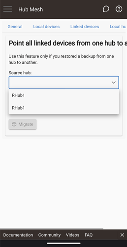

What are the options in the Source hub dropdown on the Settings - Hub mesh - Update tab? Please rename the old hub before checking and give it a few minutes to propagate the new name through hub mesh.

Can you boot the hub with two RHub1 entries? The poor thing is all confused.
I suspect that once rebooted, it will show RHub1 and a hub id in the list instead of two RHub1 entries.
Well.
Now it shows 2 "unknown" hubs with their hub IDs, one is the old one, ones is the new one--under source.
Nothing is shown under destination.
