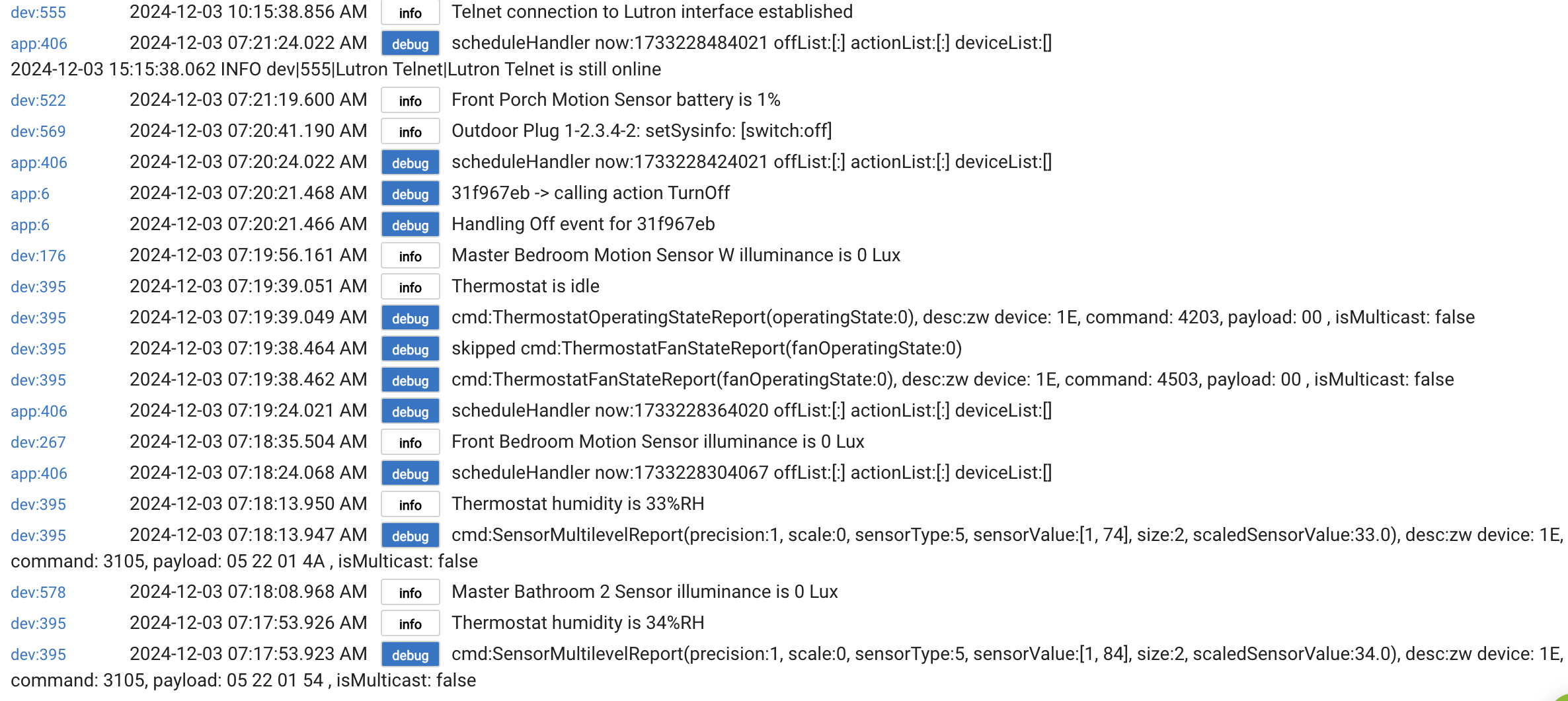

But interestingly the last thing it did was to send my phone notification that the mode had changed to away. It should have logged that notification as well, but you can see from the screenshot that didn't happen. But the other times the hub has frozen were not really around a mode change, so that is probably a red herring. I'm clueless.

I can see on my router it disconnected from wifi and ethernet around the same time it stopped responding in the logs.
