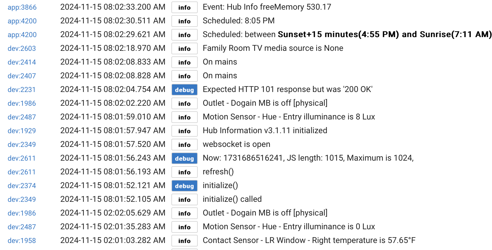

Hub "disappeared" at 2:02 AM. The logs show no errors or warnings. Just a 6-hour gap.
This morning I was able to use the diagnostic tool to reach the hub and reboot it. It rebooted at 8:01 AM and has been fine since.

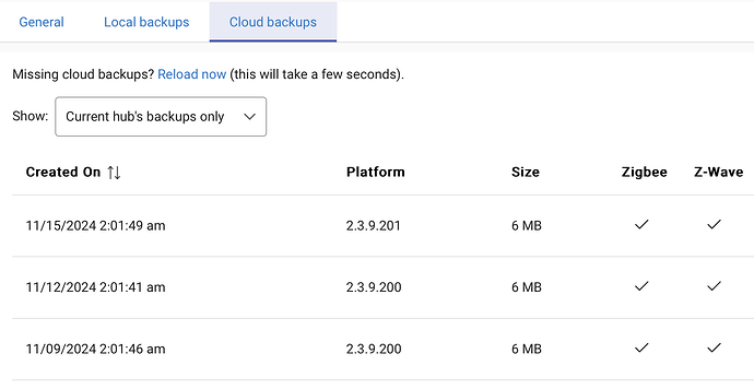

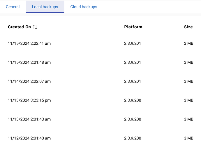

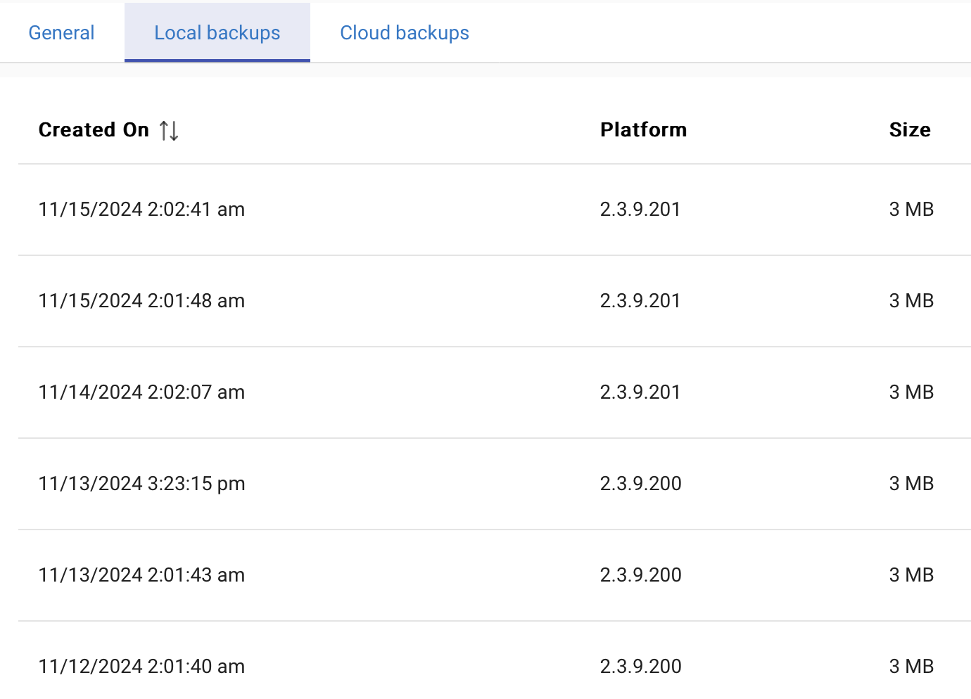

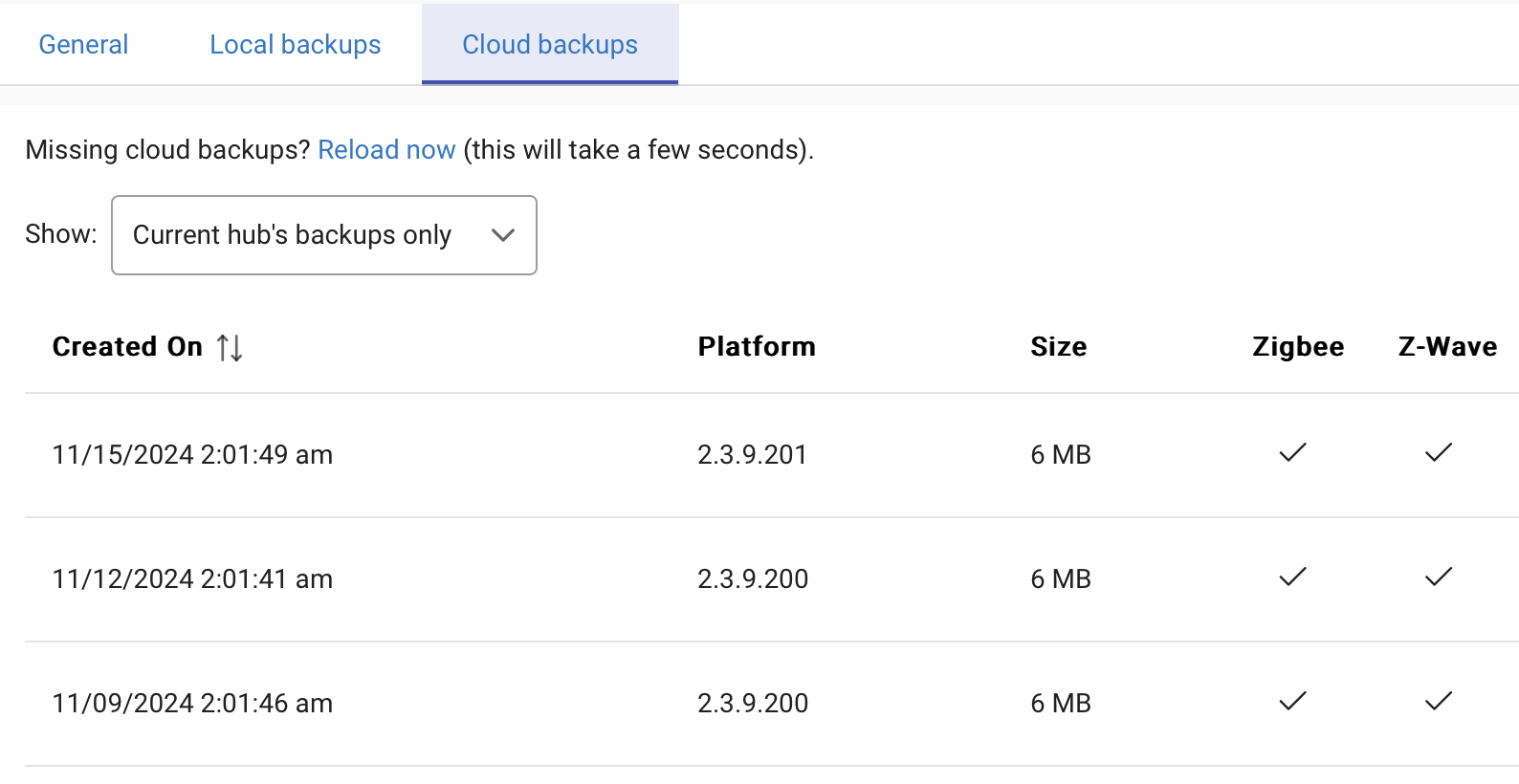

The hub is set to backup at 2:01 AM. Local update nightly, cloud backup every three days. Both backups ran just before the hub stopped responding. I notice that the local backup ran twice. I don't know why or if any of this is significant.

Thanks for checking. I have had the same issue twice now after automatic backups. In my case zwave entries were completely gone after an automatic backup. Fortunately for me the restore did work. For now; pending the forthcoming fix(es), I have disabled automatic backups.

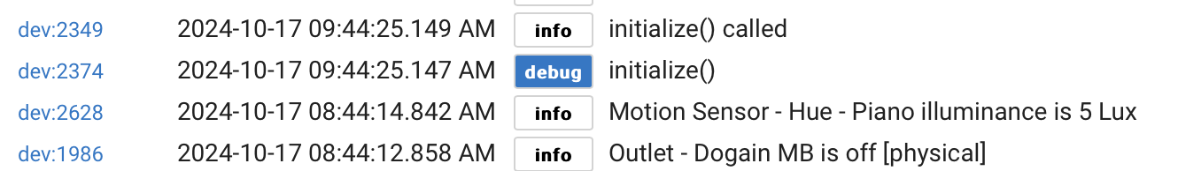

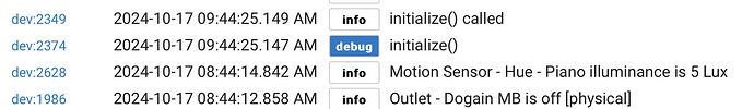

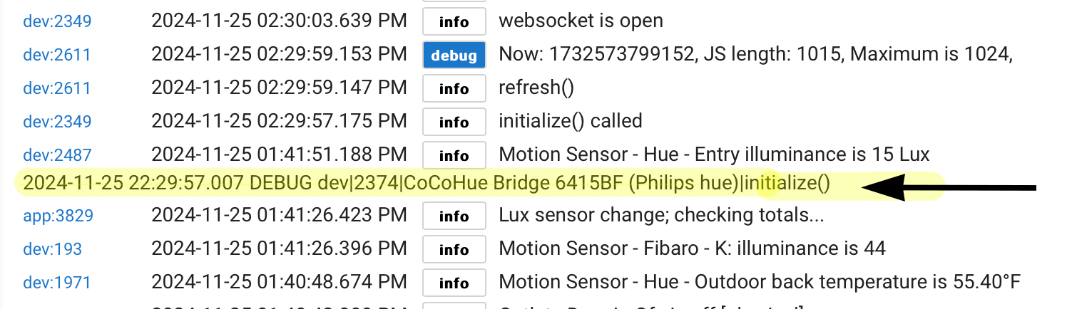

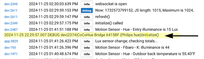

I only saw one weird thing in the logs that I can't explain. In the logs there's this extraneous line that doesn't have a device label associated with it and seems to be something going on with the Hue Bridge via CoCoHue. (Note the motion sensor in the line right above is not connected to the Hue Bridge. It's direct to the hub.)
There are no other log entries for the Hue Bridge except a group of the usual " issue parsing JSON array" errors that happened yesterday. That's not unusual and doesn't appear to impact anything as far as I can tell. I asked in the CoCoHue thread and that seems to be the consensus.

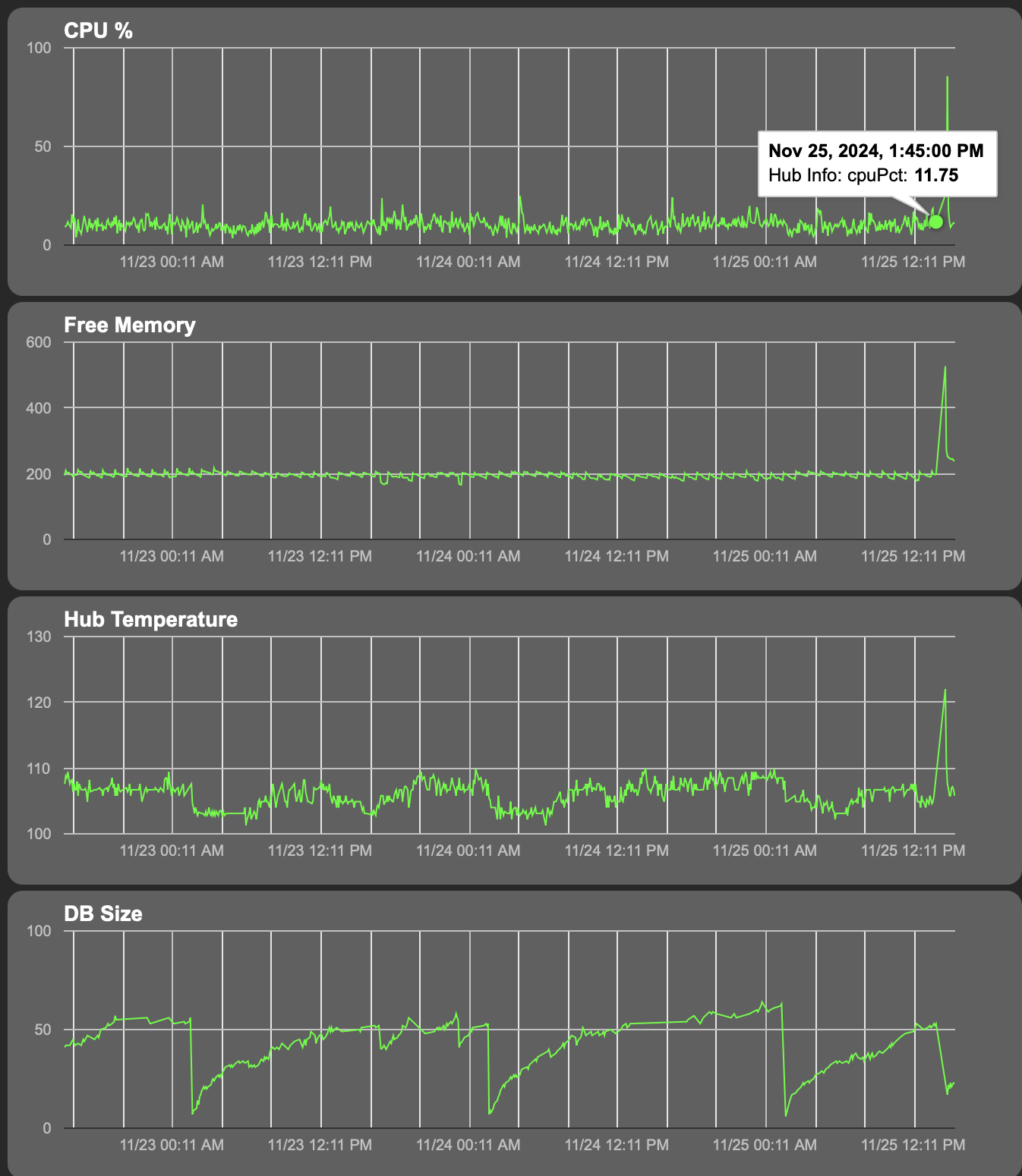

I make graphs of stats and nothing seems weird there. The spikes happen after the hub reboots. That happens every time the hub reboots, so not just because I pulled the plug for a minute.
