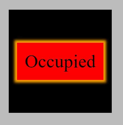

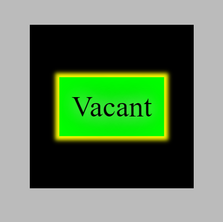

Oh yes, that is pretty easy. I’ll send some screenshots when I get home.
This is created with Tile Builder Rooms. Don't let the name put you off, a tile is a tile.
It flips between these two tiles depending on the state of the motion sensor.

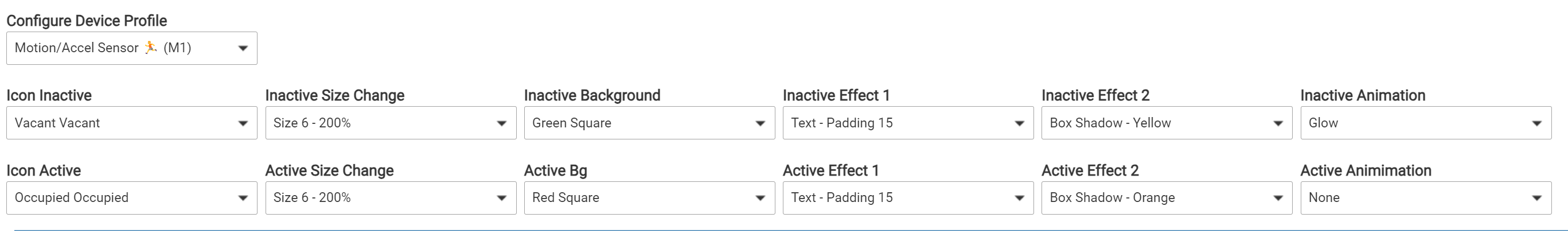

This is what the configuration screen looks like to give you some idea of your options.
I did have to add a couple of lines of code as it mainly does Icons vs Strings but it's trivial and I can do that very easily.
There may be simpler and better ways to do what you are looking for, but at least you have one response.
