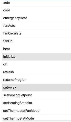

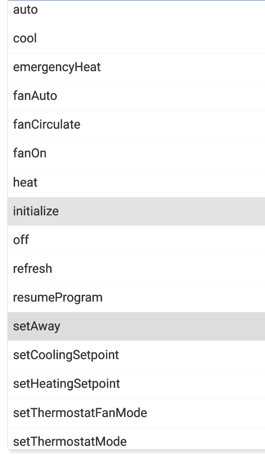

You do not need Ecobee Suite. The built-in app will do what you want. Custom commands in rule machine can do what you need. "Resume Program" will restore Ecobee to wherever it is supposed to be at that particular time. These custom commands are available.
Custom commands in the built-in app with rule machine can set Ecobee to off and "resume program." No Ecobee suite required.
