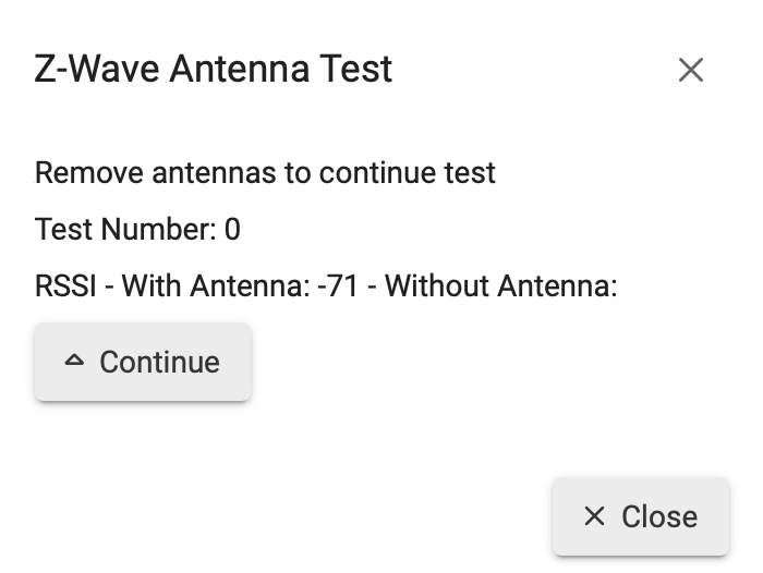

Antenna test with/without C8 Pro antenna:
Antenna test with old C8 antenna:
Hmmmm! I did the test with the C8 antenna twice, the first test was better still at -69. Hardly a scientific test as I'm thinking the device I was testing to may have changed route after I removed the antenna for the first test.
