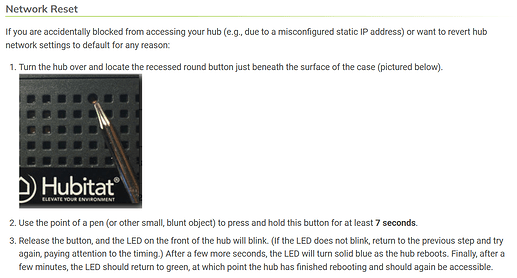

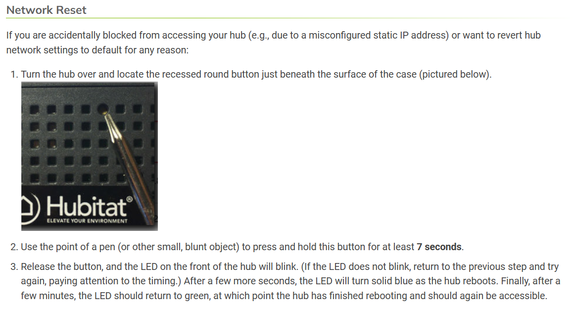

You could try below:
  1. Do a network reset on your hub (hold hidden button on bottom of hub 7s until hub reboots, )
    If no joy, then:
  2. Reboot w/advanced options selected/rebuild database option selected
Thanks for your response. I've already done #2, so I'll give #1 a shot.
Update: Network Reset did not solve the issue
