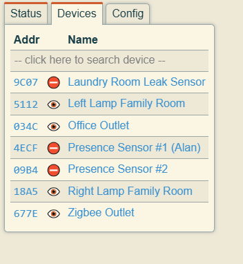

[C8 - 2.3.9.154] ZIGBEE not responding
Leak sensor is unplugged and so are the Presence sensors.

12-14 hours after setting 25 ch for Zigbee, no devices in the mapper and still cannot pair.
The Zigbee network is unresponsive.
