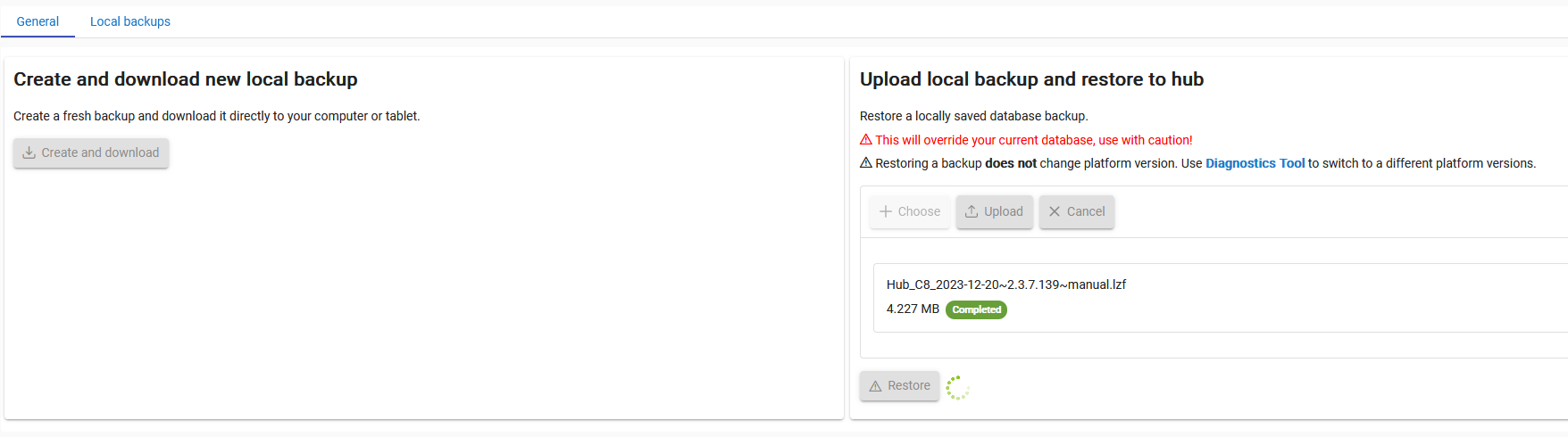

I tried to restore an old backup remotely, it was taking too long, so I did a soft reset and used the diagnostic tool instead.
Again, when I selected the local file to restore, it was still taking too long...
So I decided to open a seperate window, the UI was available, just no devices or apps.
I got feed up, then I just rebooted the hub again.
And, when it restarted it did have my apps and devices, but I am not sure if anything is missing or if database is corrupted in any way?
Will test this evening when I get home.
It would be good to see a restore progress bar
The UI was just stuck on restoring, see below:

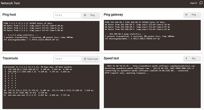

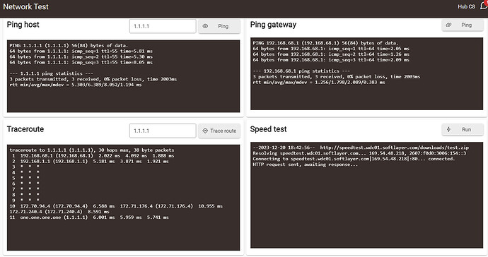

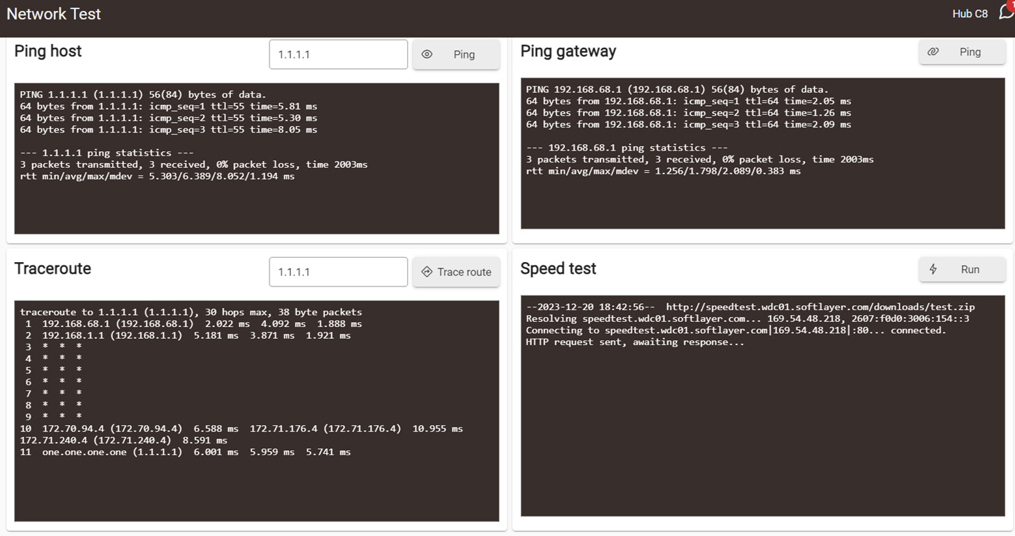

I did the network tests, see results below:
C8 - WiFi - all tests passed!
C8 - Ethernet (fixed 100bmps) - speed test = no response
C8 - Ethernet (Auto) - speed test = no response
C7 Ethernet (auto) - all tests successful
C7 (fixed 100mbps) - no response
Edit: Backup restore was done on wired connection. Will try again on WiFi which has passed the above tests.
