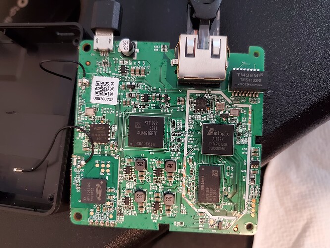

Ok so ive gotten it taken apart and didnt see anything obviously broken. Plugged it in and am seeing some signs of life (white led) but still cant connect. Im adding some pictures. Any advice what to do next?
Edit: after further investigation, the light is shining through from the room, not power to the device unfortunately.

You could try reflowing the solder on the power connector. Just an idea. Do you have hub protect?
