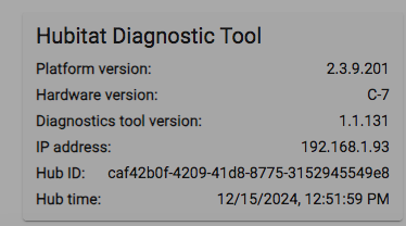

I can connect to the Diagnostic tool now.
Screen Shot 2024-12-15 at 12.52.31 PM

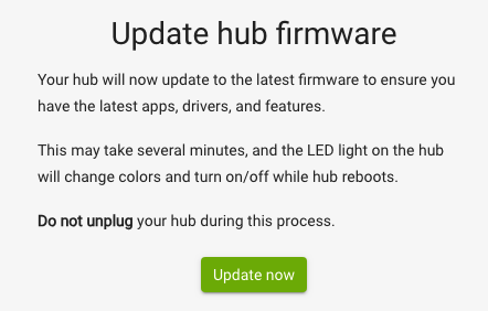

Update: I used to diagnostics tool to go back to 2.3.4.130 but When I finished that i was surprised with this:
Screen Shot 2024-12-15 at 1.08.20 PM
That resulted unto this:
Screen Shot 2024-12-15 at 1.23.55 PM

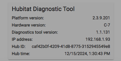

But thes was still unresponsive so I tried the diagnostics tool and found this:
Screen Shot 2024-12-15 at 1.31.17 PM

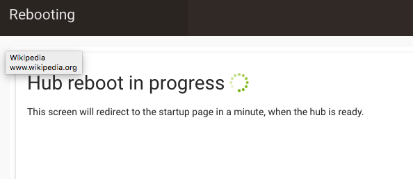

  5. After the reboot screen appeared, wait 15 minutes and still see this:
    Screen Shot 2024-12-18 at 3.44.41 PM
  6. Use the "find my Hubitat tool" and see that the IP address is still the same (Reserved in router) but still can't connect to the UI

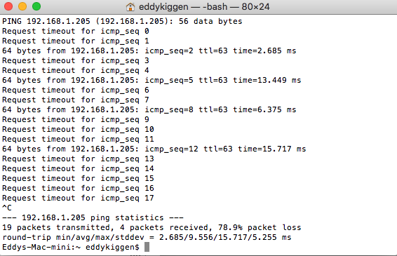

  7. Did a ping test from CMD and found connection unstable:
    Screen Shot 2024-12-18 at 3.48.26 PM

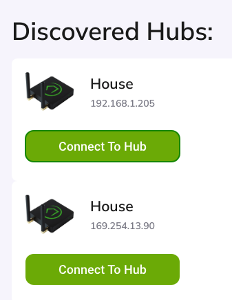

  9. then the "find my hub" tool came with a weird result. It found 2 hubs (I only have one) and the 2nd one had an IP thats nowhere within anything that my router would assign:
    Screen Shot 2024-12-18 at 3.55.34 PM
  10. Used a paperclip to reset the communication port. After a few minutes my normal IP appeared again in "find my hub"
