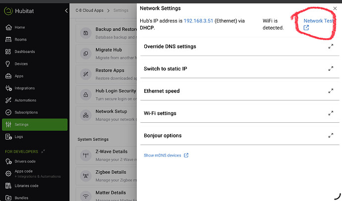

I'd start with
And then do a Ping test to make sure the hub is getting to the internet.
