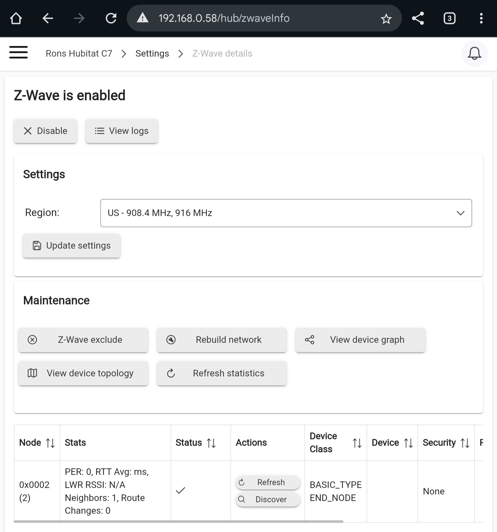

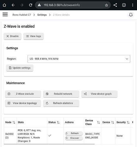

Check your Z-wave details page to see if you have any pending devices, or any devices showing three options (Refresh, Remove, Replace).
If you've unsuccessfully tried to add devices multiple times you may have created Z-wave ghosts that are messing up your hub.
Can you post your z-wave details page in it's entirety? (use windows snip)
When I bought the C8 hub, I transferred all my devices to the C8 hub and shutdown my C7 hub. Recently I powered up the C7 hub and upgraded the firmware. I tried to "include" a couple of z-wave devices. No luck. I've reset the z-wave radio, zigbee radio, and did a soft reset, and reverted back to the original firmware, and removed power to the hub. No luck. I have seen some posts where, in the past, the z-wave radio firmware needed to be changed.
