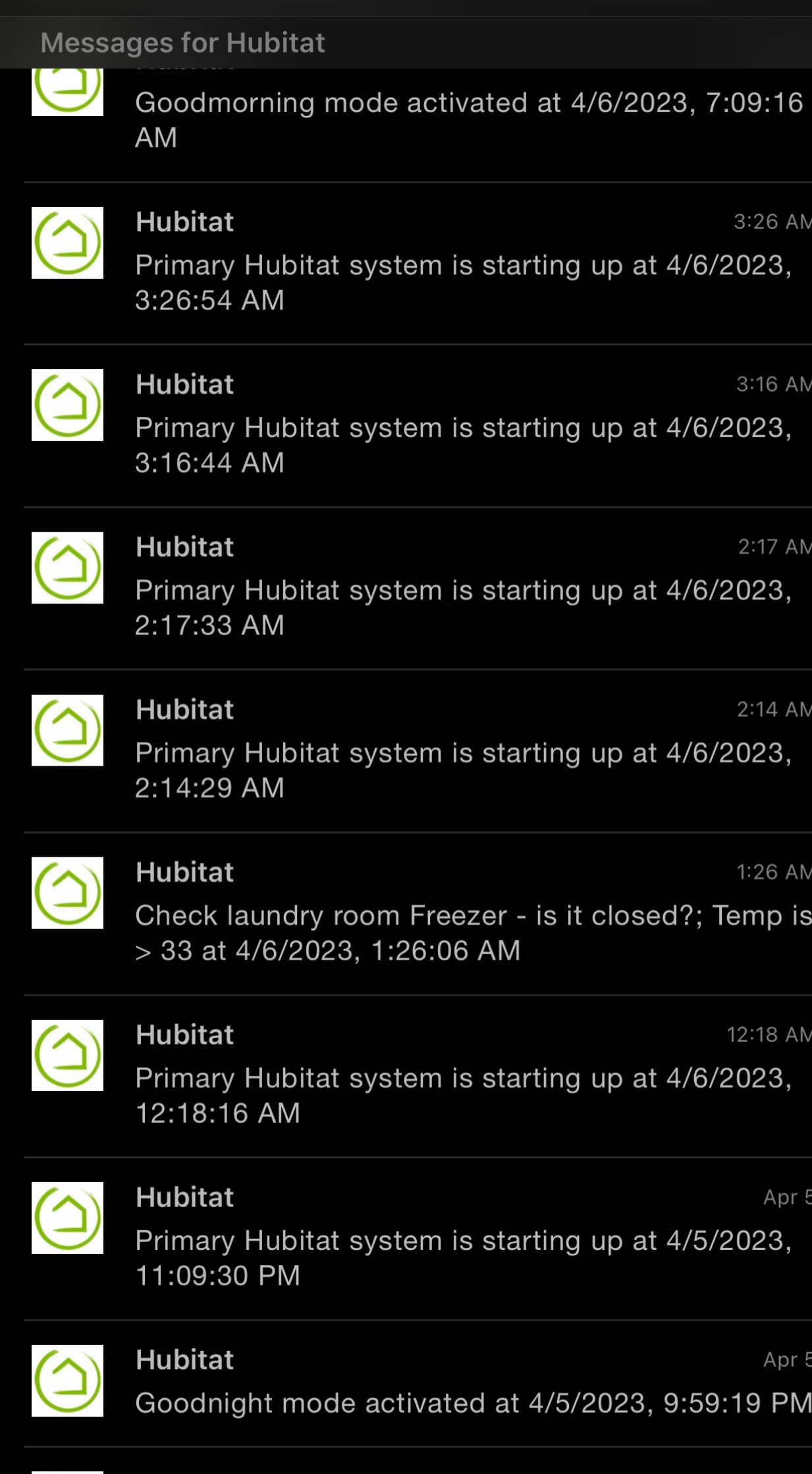

Hi there, I seem to be experiencing random reboots on my device. I honestly don't think anything changed but noticed the reboots started on April 2nd, so I went back to a backup on April 1st and still have the reboot issues. Other things I have done AFTER the restore of the April 1st restore to try and further mitigate issues:

Can support check this device and see if they have any logs that would highlight why the device is rebooting? I'd be fine replacing it with a C-8 if there is a suspicion that there is a hardware issue, but I don't want to have to if I don't need to.
