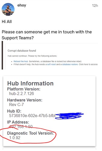

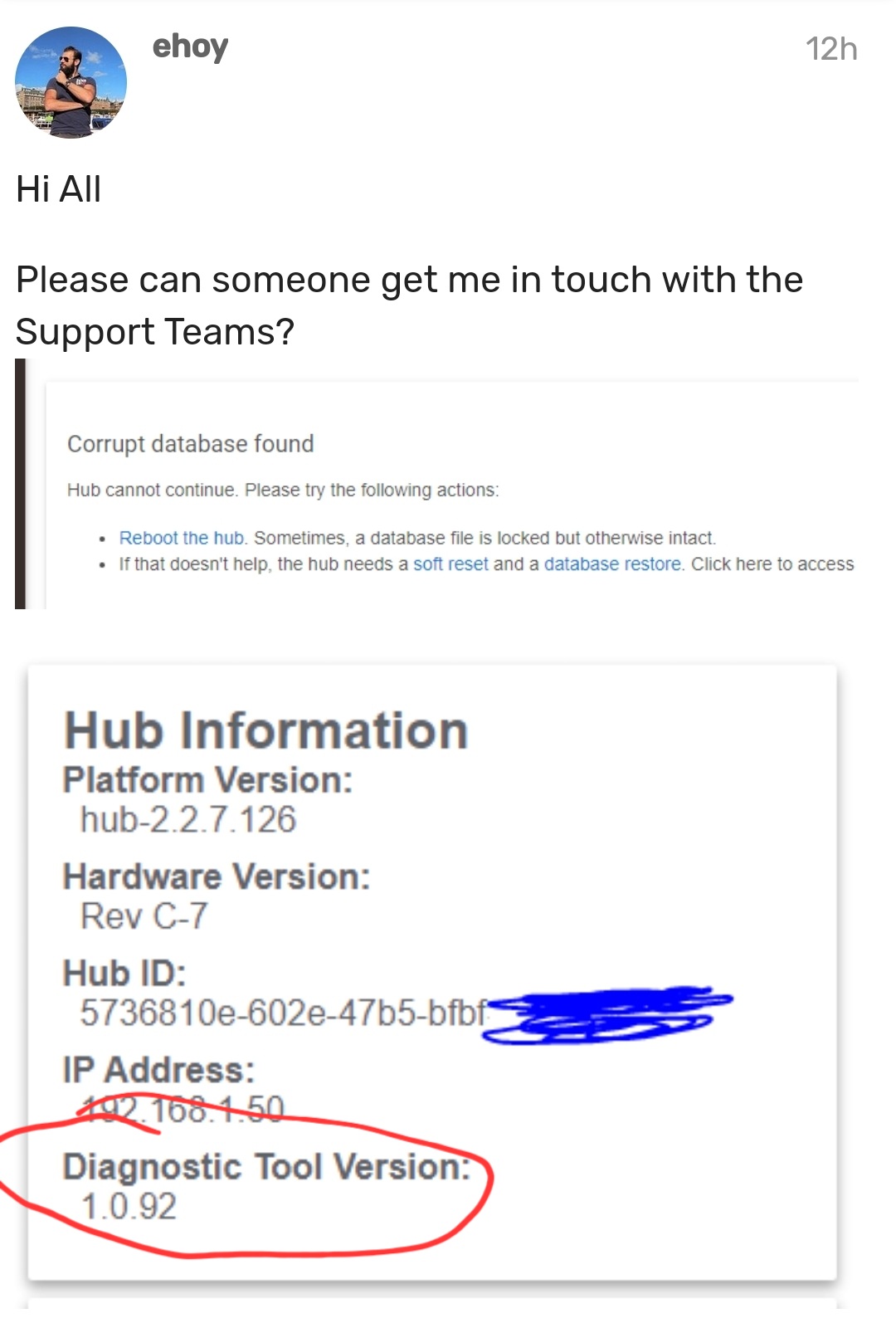

Hi All
Please can someone get me in touch with the Support Teams?
When I hit "reboot the hub", it seems to reboot-light goes to blue, etc. But nothing on the "diagnostics tool" link works.
  • Cant update
  • Cant restore
  • Tried shifting versions
  • Tied numerous Soft Reboots
  • Tried a Platform Reset
  • Now in desperation a Full Reset
Still not working... What is next please?

You were quite a bit out of date for platform (almost a year of updates). Also, I think you are behind on Diagnostic Tool also, which could be affecting how you are backing up and restoring etc.
Was this a new/unused hub, or were you just not doing updates? Was this an active hub with devices and rules on it?

Good thinking, but the OP is running the most current version:
My bad, I saw another post but didn't scroll back to the original. Never mind!

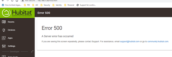

Hi All,
Have done soft reboot, Sitting at same screen as before.
When I try go to "Settings" I get the following after a minute or so,
  • How can I do a DB restore from this point?
  • Anyway to force an update of the OS? I get this update failed option pretty immediately
  • Is the local storage full maybe?
