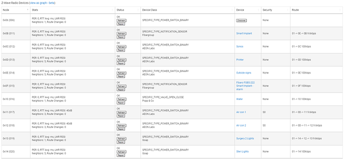

ah, there one devices in there that has a discover button in the device column this must be the switch. Should i try pair it using the buttons in z wave details page?
No you need to remove that ghost before pairing anything else. Can you post your z-wave details page in it's entirety? (Use windows snip)

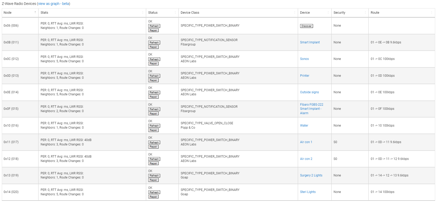

ah ok, thing is it could be the other shelly device i tried adding too! heres the z wave set up currently
Hard to tell. Click refresh on that line then click the remove button. If it won't remove you'll need a z-wave stick to remove it.
refreshed, nothing happened so I've removed it, tried repairing now still no joy. I think I'll try bringing the hub closure when I have more time and see if that helps
If you removed that device that had the discover button on it, that is good. That was a ghost and they will hose your mesh. At this point factory reset the device, run an Exclude on it, then include.
