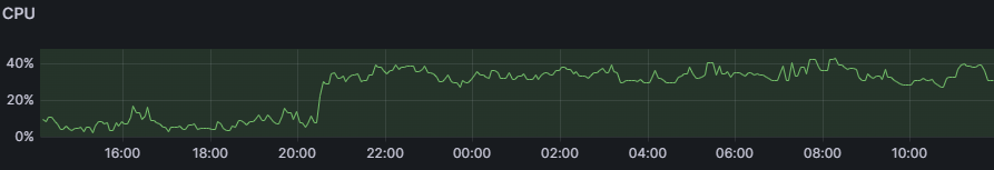

CPU usage suddenly went from averaging about 4% to about 35% last night around 8:30pm.

Upon further investigation, it appears the CPU % shot up at the very moment the zigbee log socket went dead. Bug?
I tried comparing app and device stats by pasting them in excel but it's super tedious (a reset button would be great!) and I didn't find anything interesting. I also tried disabling almost everything (apps & devices), including InfluxDB telemetry, to see if anything made a difference - no difference. The "CPU avg" reported by http://hubitat.local/hub/advanced/freeOSMemoryHistory remains unchanged at around 1.3 (it was 0.2-0.5 prior to this event).
