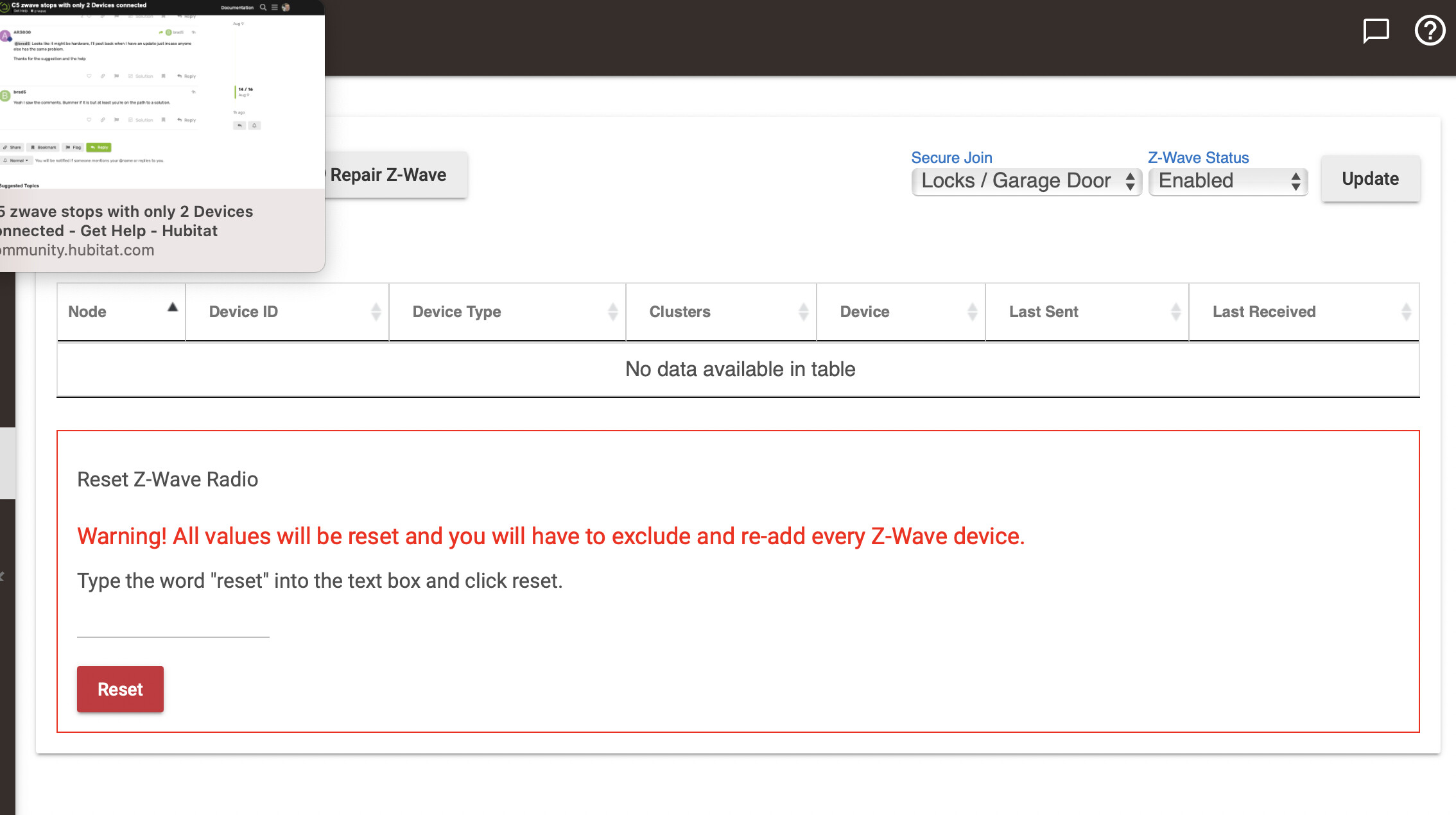

When it stops working the zwave settings page shows no devices and the implant sensor stops sending / receiving temp settings, however the led strip comes on.

yep they just disappear completely, you can still see them from the devices page but if you try to refresh or do anything with them nothing happens.

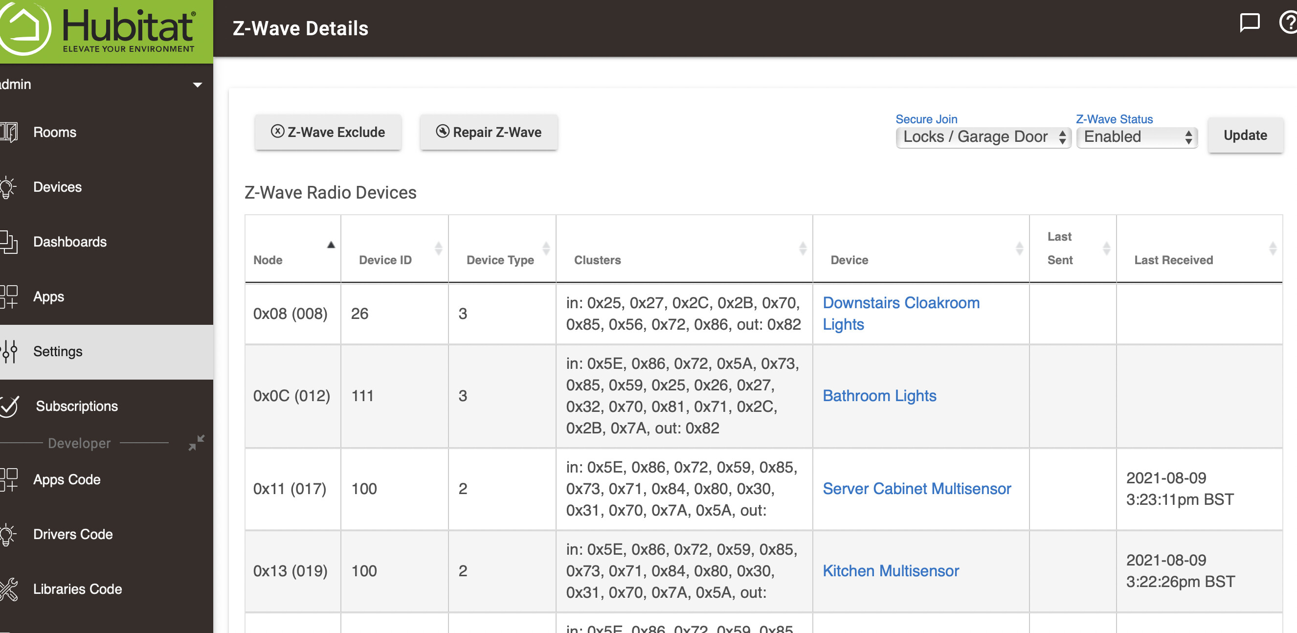

I've just come to this thread with exactly the same issue with my C5 (2.2.8.152)- the Z-Wave devices stopped responding completely at approx 12pm UK time, the Z-Wave page on the hub showed the devices in the list, I rebooted the Hub via the Web GUI and now the Z-Wave page is blank.
I then did a complete power cycle (shutdown via Web UI), remove power to Hub, wait 2 minutes, then power back up brought all the devices back again:

screenshot of the devices missing from the settings/zwave is 100% the same for me
