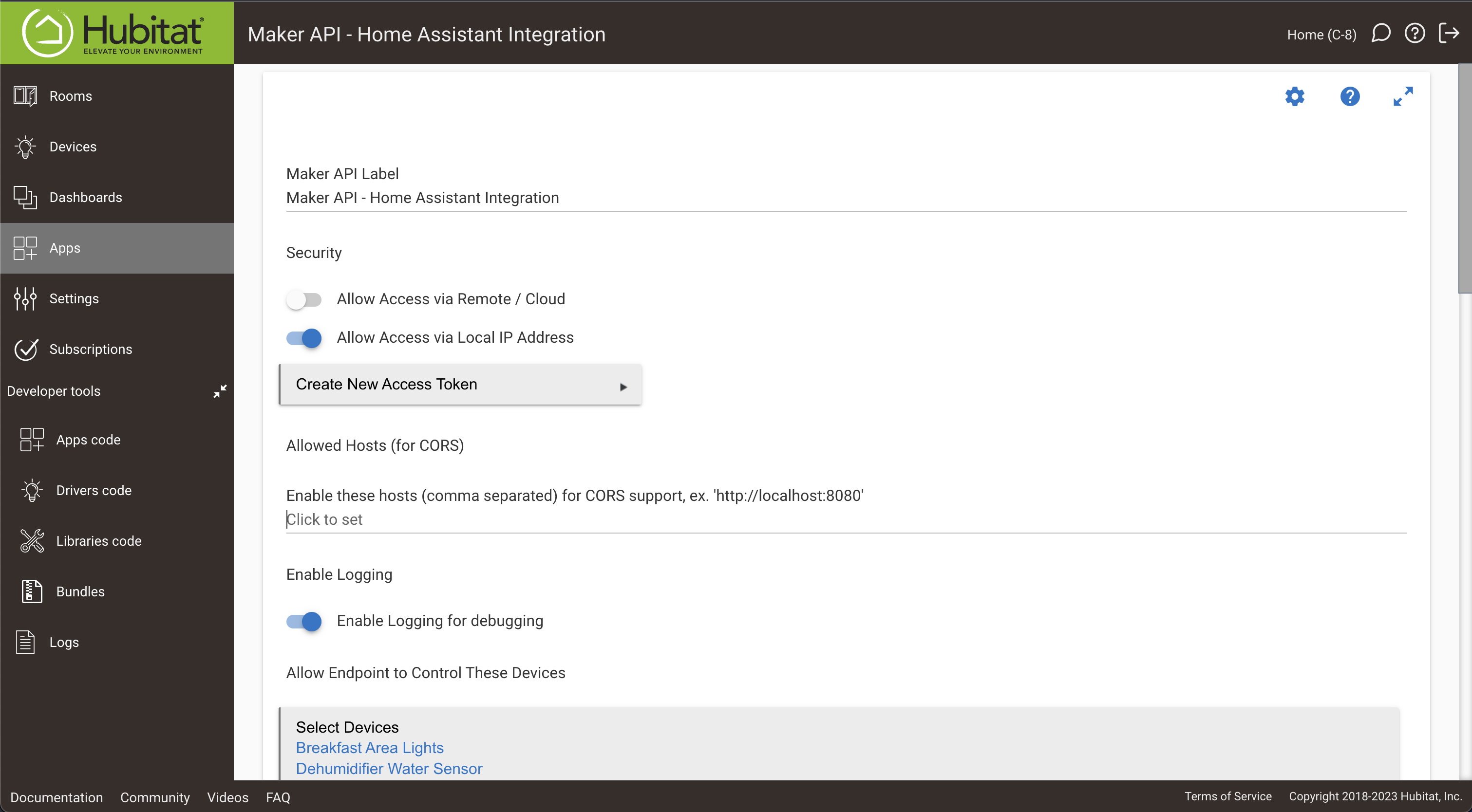

I have screenshots of the Maker API configuration and debug logs, but apparently my account is too new to attach images to posts. I'm going to browse around and see if I can attach photos to a later post.
