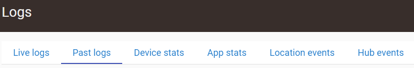

Also look at your Device Stats and App Stats and see if there are any devices that stand out in terms of high levels of activity.

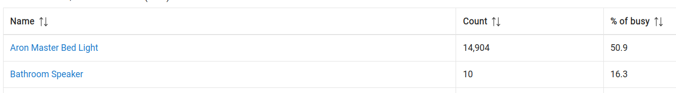

Nothing showed up in the logs for the thermostat (at all). However, when looking at the device stats, one of my devices is eating up resources...
That device is a ThirdReality ZigBee Plug. It is constantly reporting power since the driver doesn't seem to be able to disable it. However, it hasn't been a problem till recently.
That's a lot of % of free/busy...I think @rlithgow1 is familiar w/these devices. Rick - this look normal/acceptable for the plug? I know there was a lot of conversation about the excessive reporting.
Pretty easy to test if it's the root or part of the root...replace it in your automations w/a place-holder virtual device using Settings> Swap Apps Device and then remove the plug from your hub and reboot and keep an eye on things.

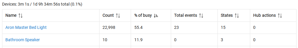

50% of what ? Show the total busy time for devices.
Also are you using the system driver or a community driver? If so which one?

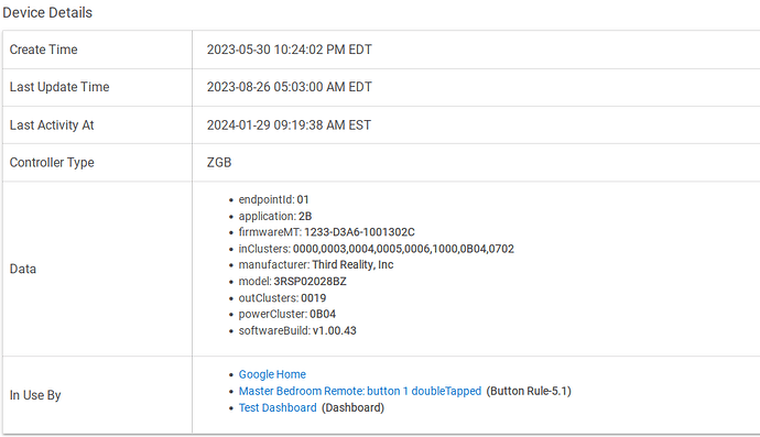

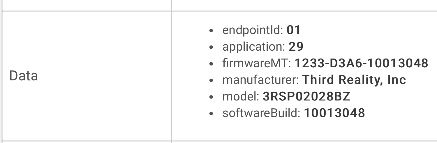

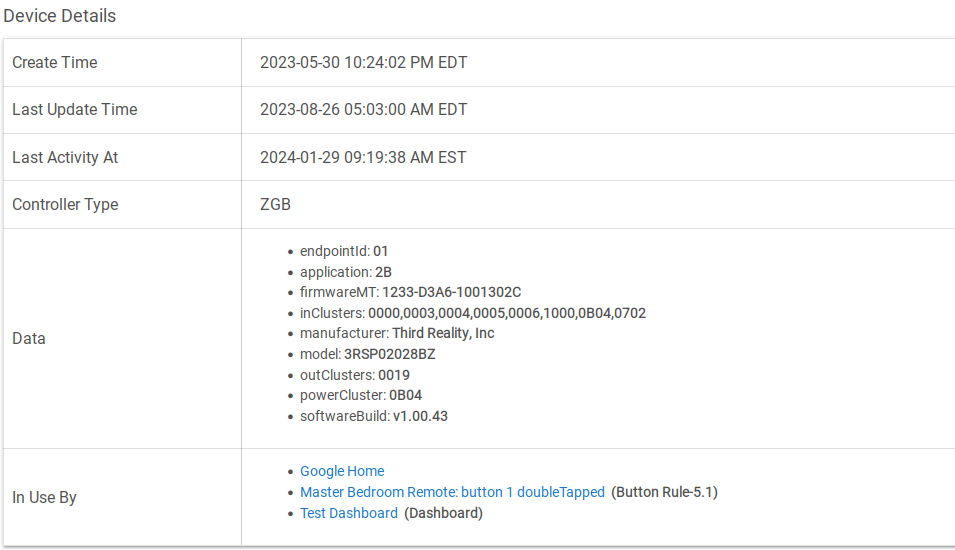

Make sure you are on the latest firmware. Show the data section of the device page. Would look something like this :
I see I forgot to show the absolute time. It is shown. It doesn't seem to be that busy in real time. I'm not sure that is the root problem, though. That plug was working fine for months.
I'm attempting to update the firmware now.
