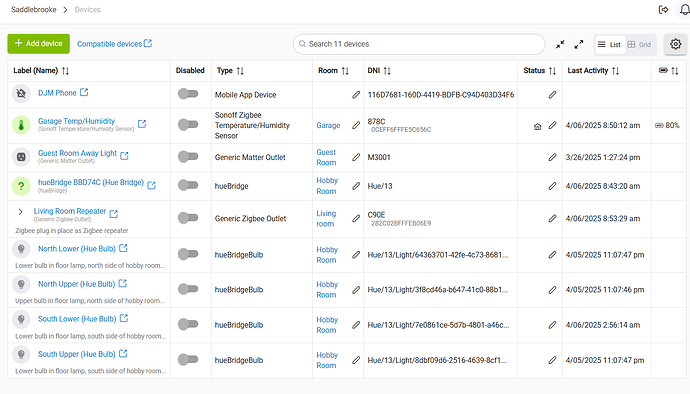

Ladies and Gentlemen: Yes, I know I come in with a lot of questions but I need to learn.
The Situation: I just moved in to a new place. I "factory reset" my C-8 (not the Pro) to set things up from scratch.
  1. I have ONE rule, to turn on then shut off a night light.
  2. I have VERY few devices in the system and none are out of the ordinary. There will be a bunch of Zigbee switches, dimmers, and fan controls going in soon.
  3. Although thermostat control and scheduler are there, they have nothing in them as I need to read up on how they work. Just a few other apps.
  4. This hub was moved from another home where I had a bunch of Lutron, some Hue, and a few Zigbee devices running; it all ran without a hitch.
The Question: Even with virtually nothing in Rules and a handful of devices, the following happens. I will go into my hub to look at things and have a message waiting, telling me I am low on memory and should reboot. This makes no sense to me. Is my C-8 starting to die? Is it telling me to buy a C-8 Pro so that Hubitat will - a week afterward, release the C-9?
If there are any things you want me to post here aside from the attached screenshots, please let me know.
Thanks!
