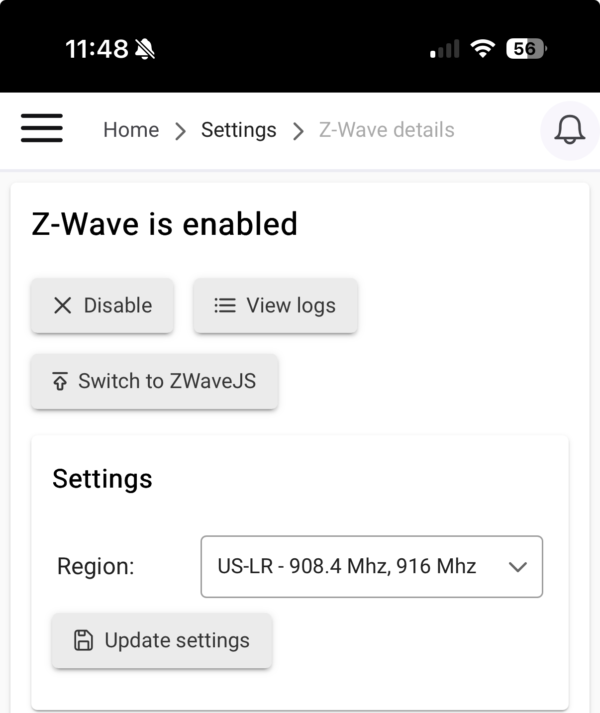

Which ZWave stack are you running (ZwaveJS or ZipGateway (legacy))? If JS may want to see if running this little app fixes it next time: https://raw.githubusercontent.com/thebearmay/hubitat/refs/heads/main/apps/zwInterview.groovy
(Shouldn't be needed, but if it corrects your issue it will be an indication on where to look for a true solution.)
@thebearmay
Looks like it’s running ZipGateWay.
I didn’t realize there was an option for Zwave stacks.
I suppose I could try switching and see if it gets better.
Only production released for the C8-Pro ATM, although some of us in the Beta group are playing with it on C-7s and C-8s.
