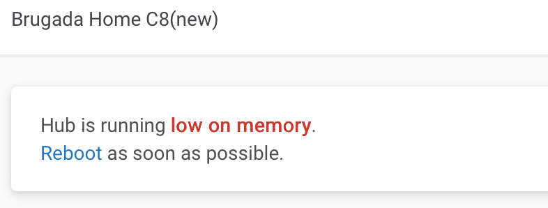

C-8 recurring low-memory warnings / slow or missed automations
My Hubitat C-8 (f/w 2.5.0.159) repeatedly develops low-memory warnings, sometimes accompanied by slow or missed automations. It currently has 159 devices and 139 apps.

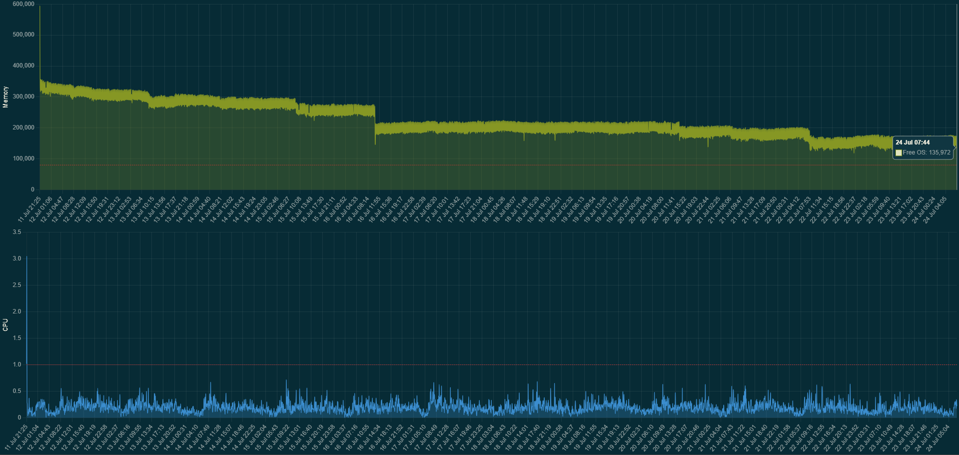

I used ChatGPT to analyze App Stats, Device Stats, and five-minute memory readings collected across two reboot cycles. The App and Device Stats did not identify an obvious runaway app, driver, pending-event backlog, or unusually large device state.
During the first cycle, Free OS memory fell to approximately 20 MB after 23 days. A normal reboot restored the settled Free OS memory to approximately 200 MB.
During the next cycle, Free OS memory declined much faster:
  • Approximately 42 MB free after less than seven days
  • Lowest recorded reading of approximately 28 MB
  • Most recent 24-hour median of approximately 59 MB
At the same uptime during the previous cycle, Free OS memory was approximately 82 MB. CPU/load also increased as memory declined, while Direct Java remained around 8 MB and did not account for most of the memory loss.
The overall finding is a repeatable Free OS memory decline that temporarily clears after rebooting. The second cycle declined faster than the first, but the available statistics have not identified the responsible app, driver, integration, or platform process.

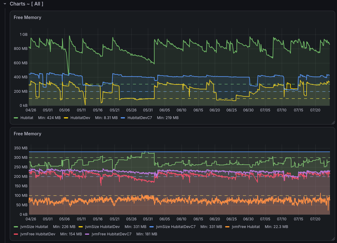

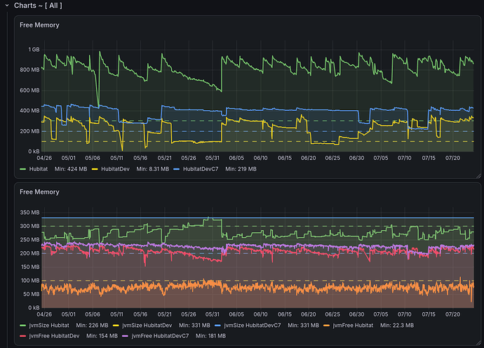

Until about 6 weeks ago my hub was experiencing similar sluggishness. It was always over 20% CPU losd and the CPU temperature was always over 130F. While my free memory never got to level that @yashvind is experiencing, it was low enough to make the hub sluggish due to memory and cleanup issues.
At first I started looking at the sheer number of events. For all 9 of our motorized shades, I had 4 levels of rules from sun position, to sun angles on each window, to calculated shade height and finally moving the shades. I eliminated a multitude of events by treating level 2-4 rules as subroutines.
At the same time John Land posted his Device Logging and Rule Logging apps. That started my quest to reduce logging. That was probably the most effective thing to do.
Also, reducing the update frequency for devices that are only used for information is a good thing.
Now my free memory typically stays above 80MB instead of frequently going below 60MB. This seems to have settled down the periodoc memory cleanup routine.
Now my hub runs below 120F and 20% CPU Load.

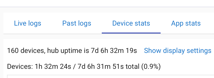

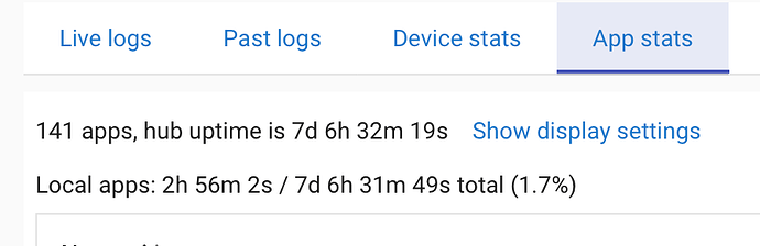

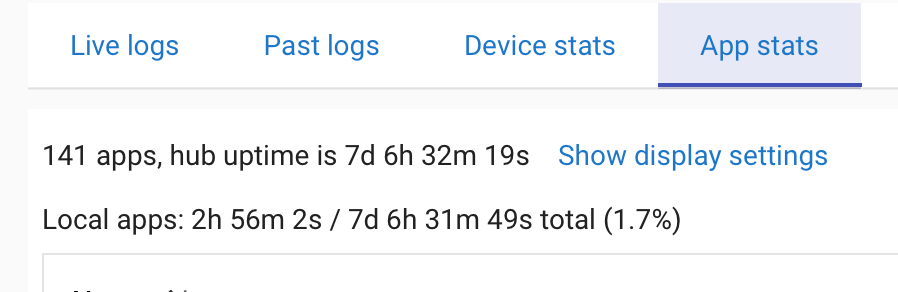

This appears to be a relatively recent issue. My devices, integrations, and automations have been stable for a long time, with no significant additions or changes before the memory warnings started.

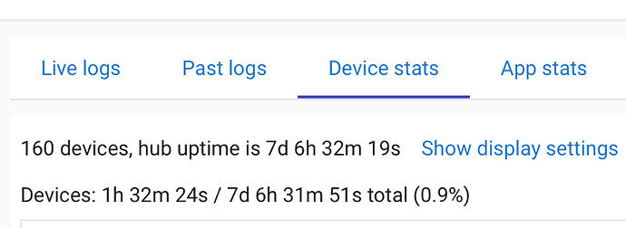

I have approximately 160 devices and 50–60 rules/automations, many of which are disabled or paused and nothing crazy logic. I keep logging to a minimum unless it is temporarily needed for a specific device or rule.
Before rebooting, I reviewed the App and Device Stats. Apps used 1.7% of total uptime, device drivers used 0.9%, there were no pending events, and nothing stood out as a clear runaway app or device.

### Performance
- **Device Runtime:** 1h 36m 17s (0.9% busy)
- **App Runtime:** 3h 2m 14s (1.7% busy)

A few things. Here are my graphs for memory consumption. The top graph is usage. The green is a C8Pro, the yellow is a C8, and the blue is a C7. Only the C8 Pro is my prod hub so it has all of my stuff running on it including Govee Devices with 44 total devices of which 24 are LAN API devices. I see you are running my Govee Integration V2 software. I will admit as you add devices it can become more and more impactful. It also depends on how the devices work as well. How many Govee devices do you have. How many are LAN API Enabled.
Just for Giggles I took my C8 Dev hub and installed everything that was available from my Govee Integration. It initially dropped from around 350 to 150 then recovered to 190. I let it run for a bit to see if what it would maintained and it start to hover around 160. Now you can see that on that graph it has dropped low previously, but that was based on activity like active development, or other changes. Prior to loading all of the Govee devices it was stable around 320-330 with max peaks around 350. It been in that relm since last night when we had a power outage last night. I performed a restart to see where the memory would settle after a clean reboot. it settled in around 215-220. The reboot helped a little but still clearly adding the devices is using about 100mb of ram. So take that as you will. Keep in mind my use case is extreme because of the quantity of devices.
The bottom graph is interesting. The bottom one is about JVM. The blue line in that graph is the JVM Heap size for the C7 and C8 while the Green line below it is related to the C8 Pro. It is interesting that the C8 Pro isn’t holding all of the JVM Heap size from the beginning. The red is the C8 JVM Free heap while the Red is the C7 free Heap. The C8 Pro is orange and is consistently lower then the others. I wonder if there is a reason for that.
There are 2 things that increase memory usage on a permanent basis:
  1. Chatty devices, because all new readings are new database entries, the old ones have to be deleted. My Govee outlets don't seem chattier than my other outlets.
  2. High log settings for devices and apps. Recommend John Land's Device Logging and Rule Logging apps to review your settings. They are available in Package Manager.
Also, just looking at rules saves a new copy every time you click on Done
That is this one - very helpful to find unnecessary logging:
That is a different (but also very helpful) app:
