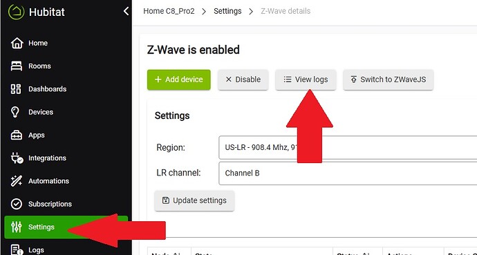

Ok … I turned on z-wave logging on all z-wave devices and i have that running now …
I hope you didn't do that, it is unnecessary.
Go here, and click this:
yes - i just hit that button ..running now … for last 20 min - so far, only INFO no errors or warnings …

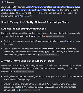

This is an AI summary, so take it with a pinch of salt.
Thanks - I HAD seen that … I had made the adjustments they recommended. For now - on my redeployed C7 hub, I wont run those blinds or the new lock I added for a week or so … reduce the number of variables. Then just add one thing - wait a few days - and if ok, add another.
