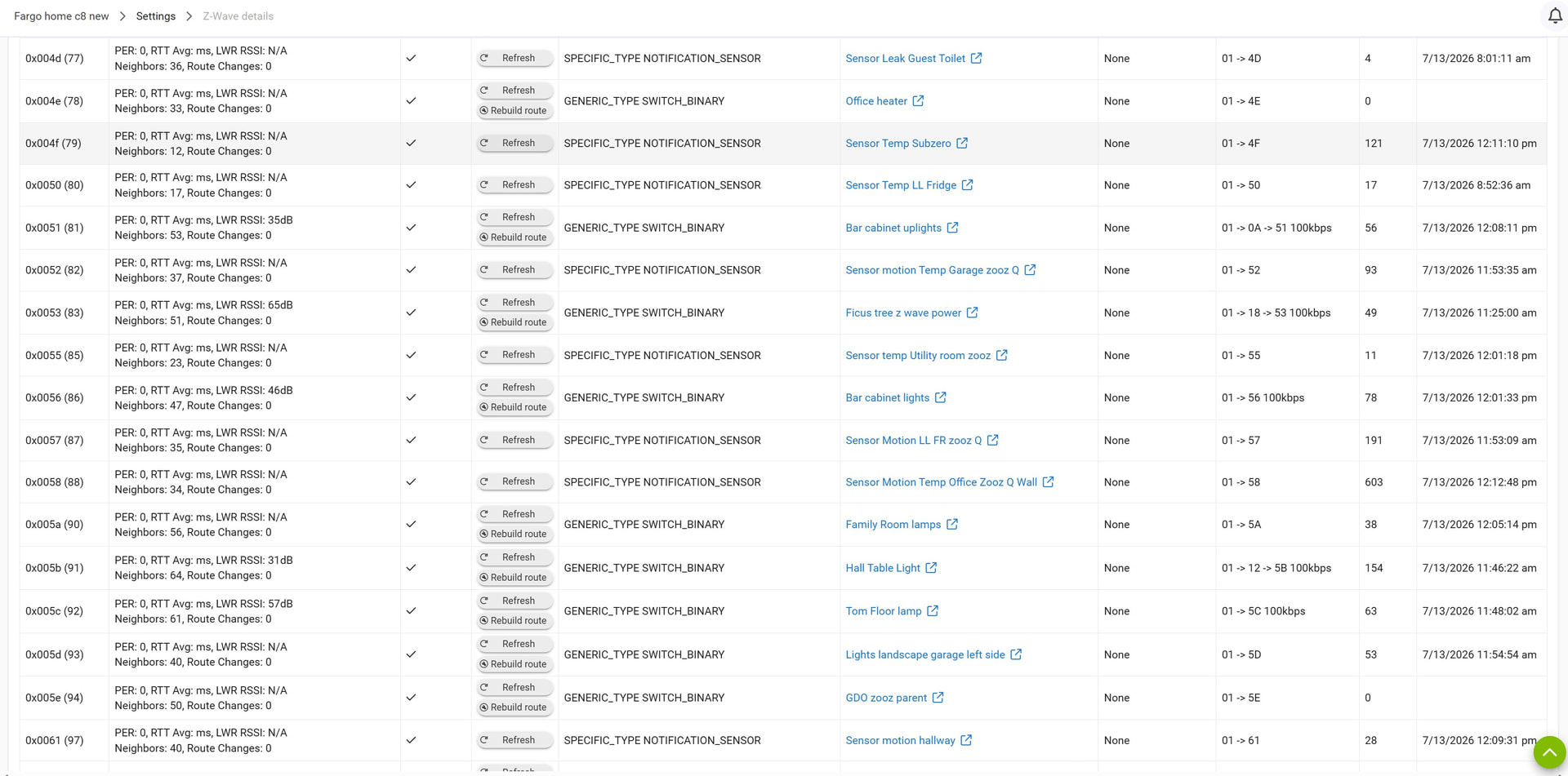

  • Removed two incomplete secure inclusion/orphan nodes using Silicon Labs PC Controller (secondary controller).
  • Verified no remaining ghost nodes in Z-Wave Details.

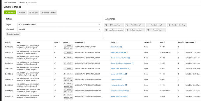

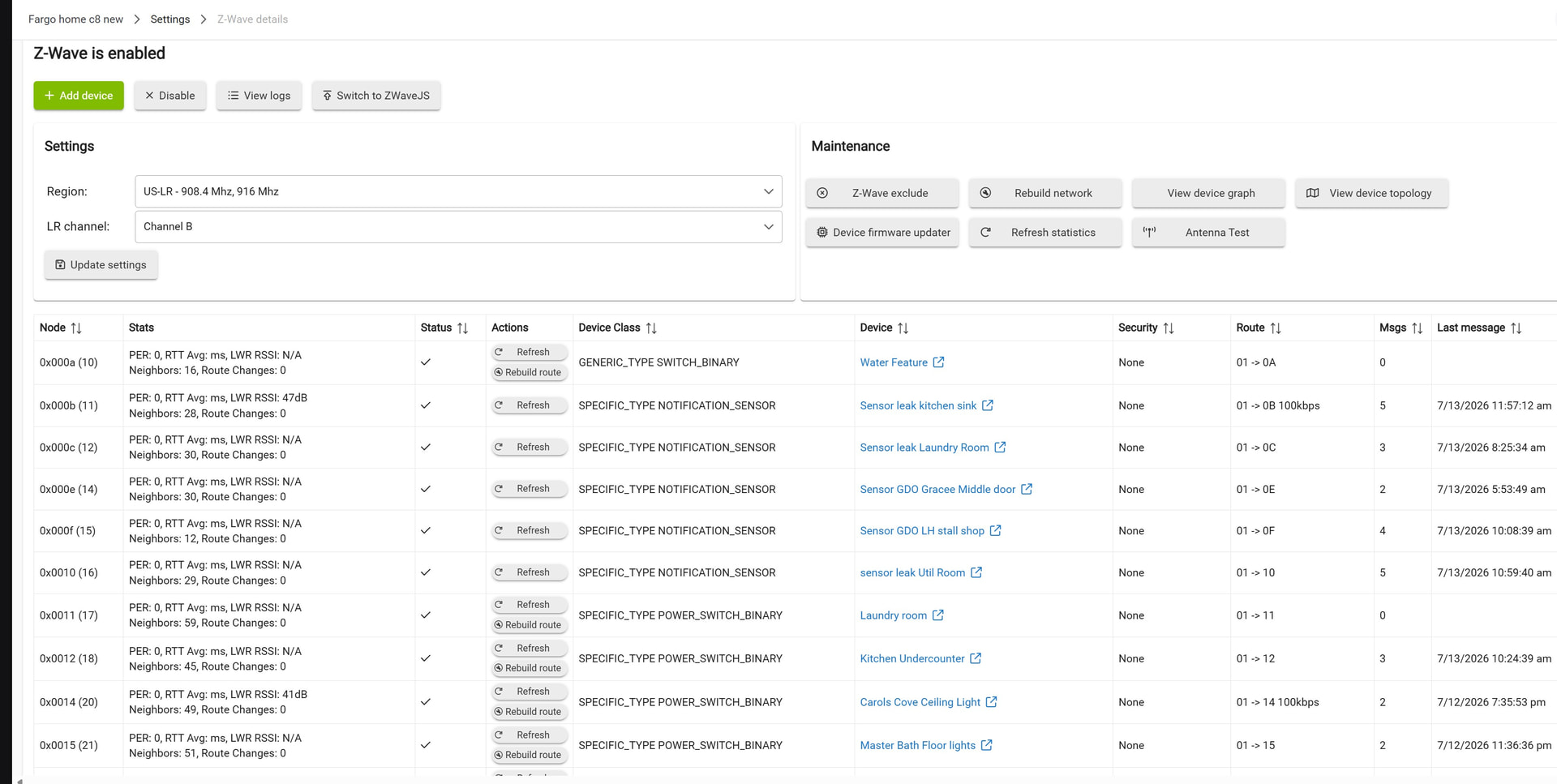

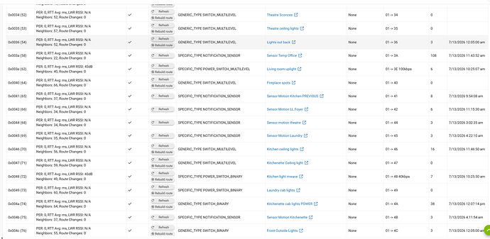

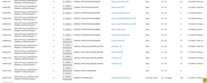

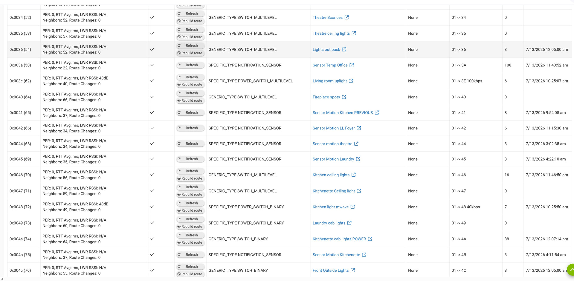

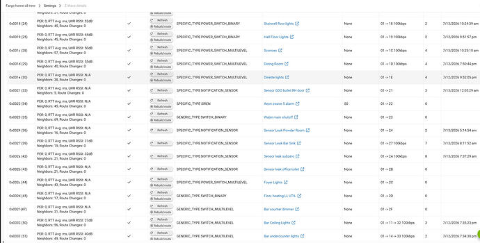

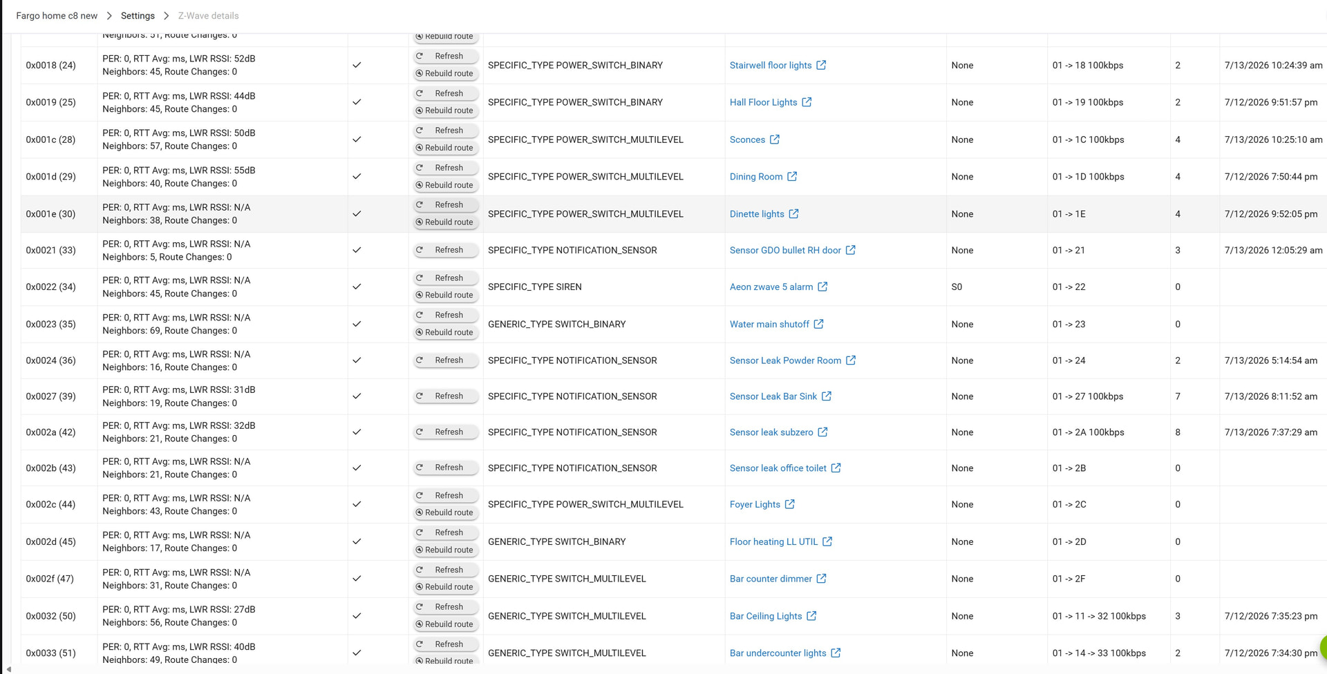

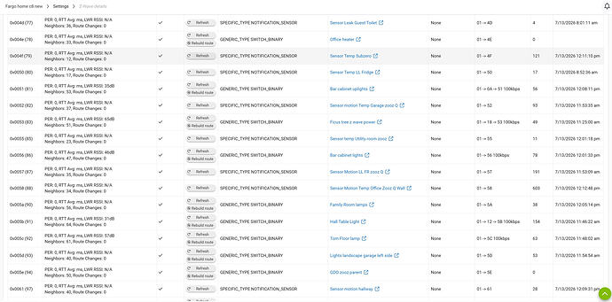

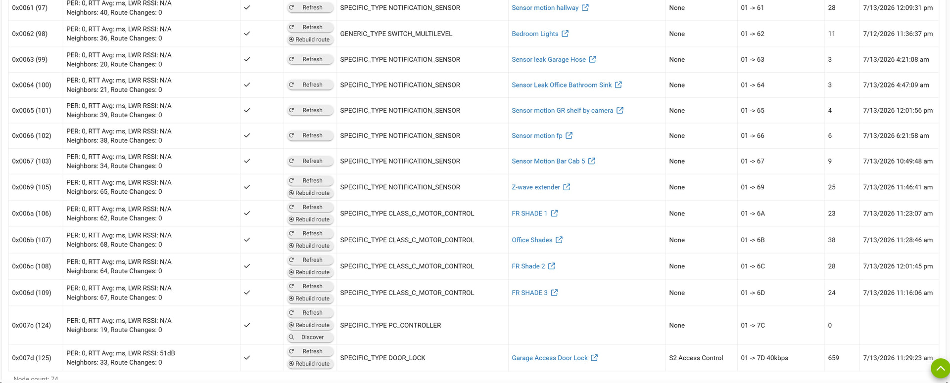

Can you post your current z-wave details page in full? (Use windows snip)
Also are you on ZIPgateway or z-waveJS?
Hi Rick - currently BACK to classic z-wave not js…

Remove the controller ghost to start. If anything is using that as a repeater it will slow things down when not installed. That said, make sure the old hub is off. What do your logs/app stats/device stats say about things? You could have a rogue device since you say for a long time it worked fine.
Actually, that is not a GHOST - I had left the controller on there from when I was doing ACTUAL ghost removal. I should just be able to unjoin it and I will do that now. Then we can come back to logs …
That's not a problem, and it isn't causing the issues you're experiencing either. There are no ghosts or stranded nodes on C-8 Pro.

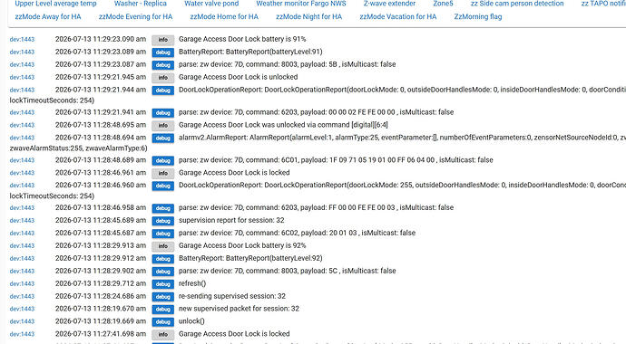

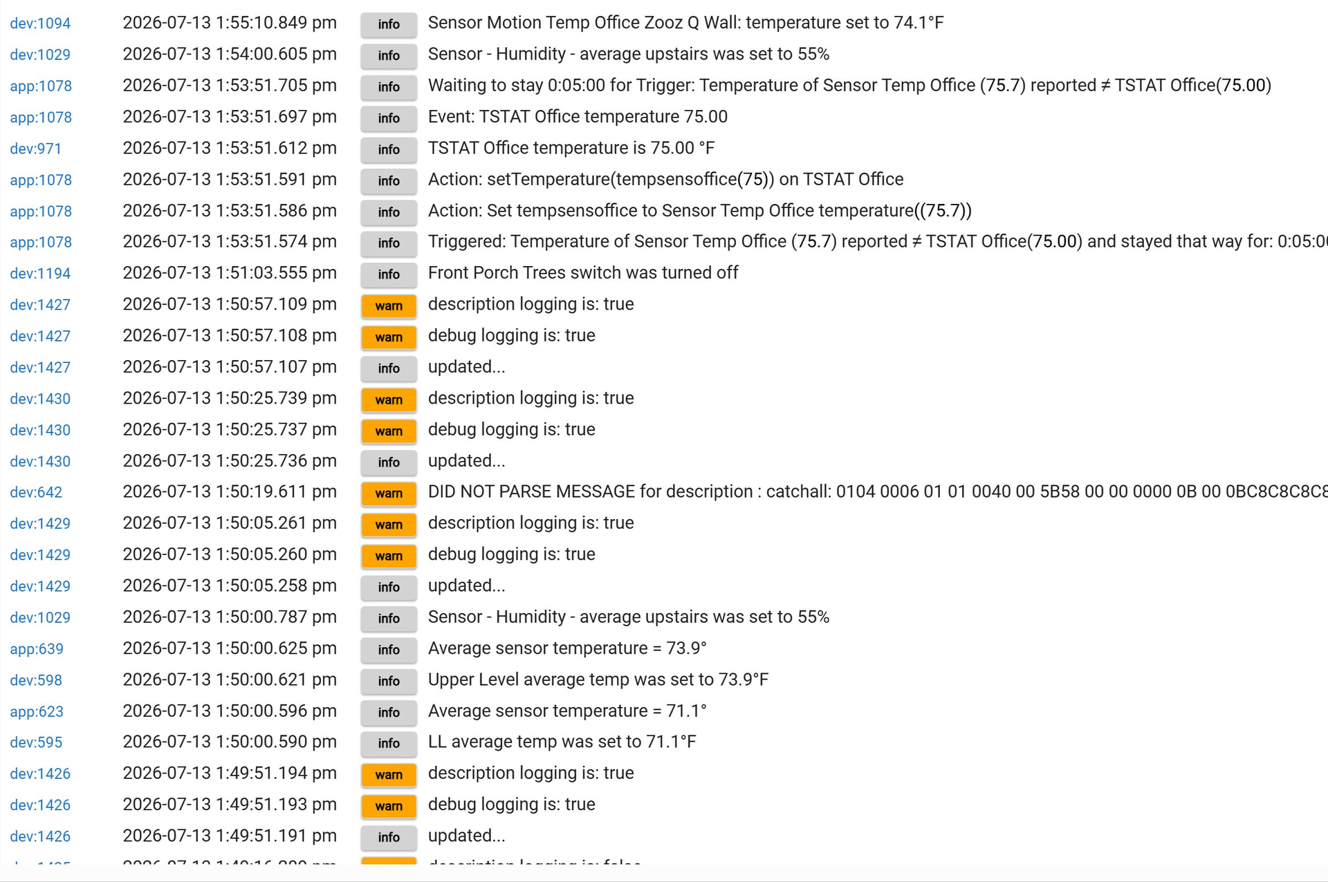

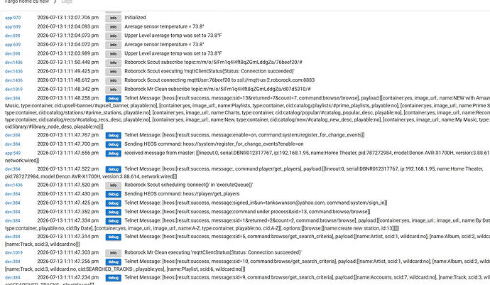

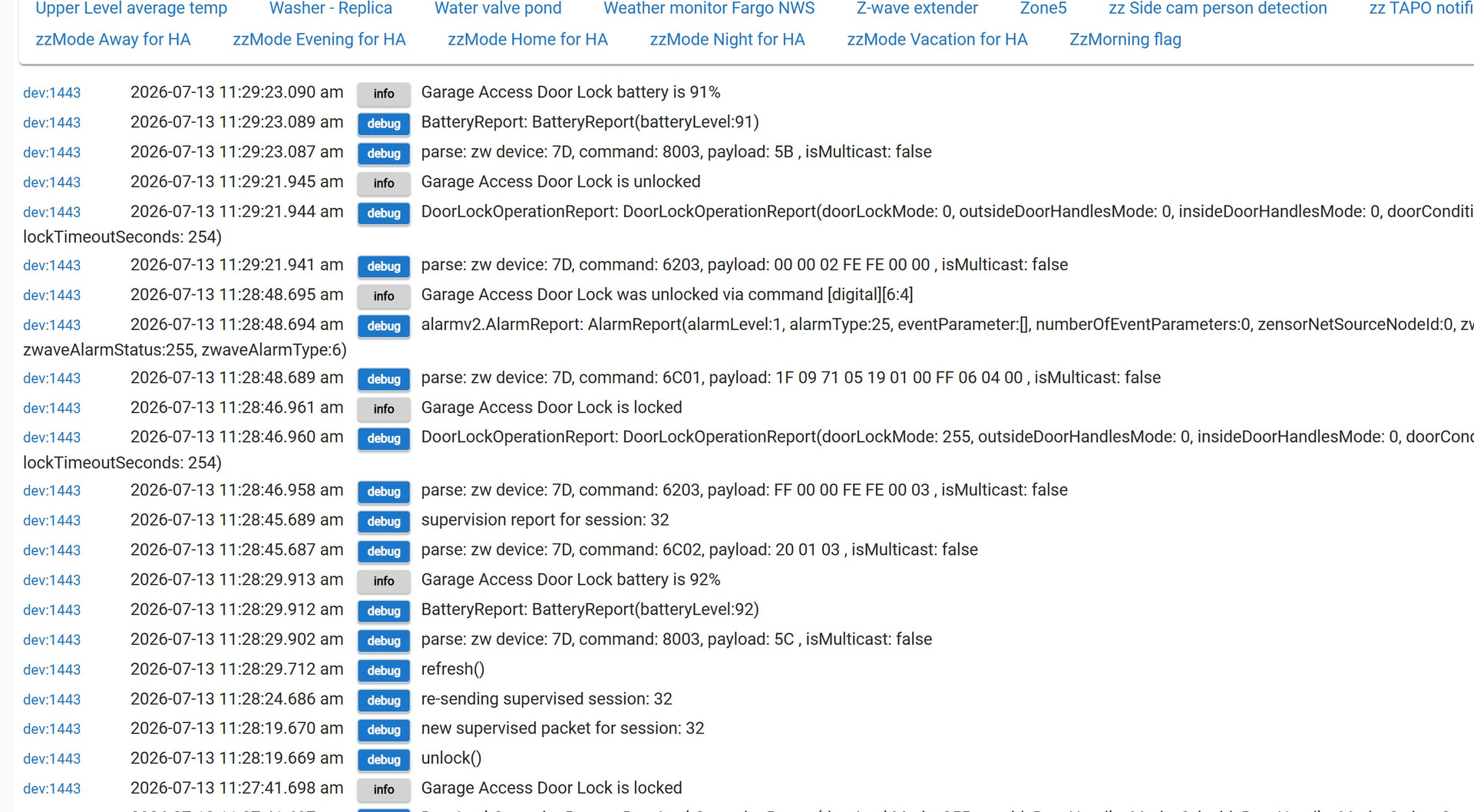

Can you check the z-wave logs to see if you have any spammy devices? Or devices with frequent power reporting. Spammy/noisy devices or frequent power reporting will jam up the controller and introduce random delays and a general lack of responsiveness.

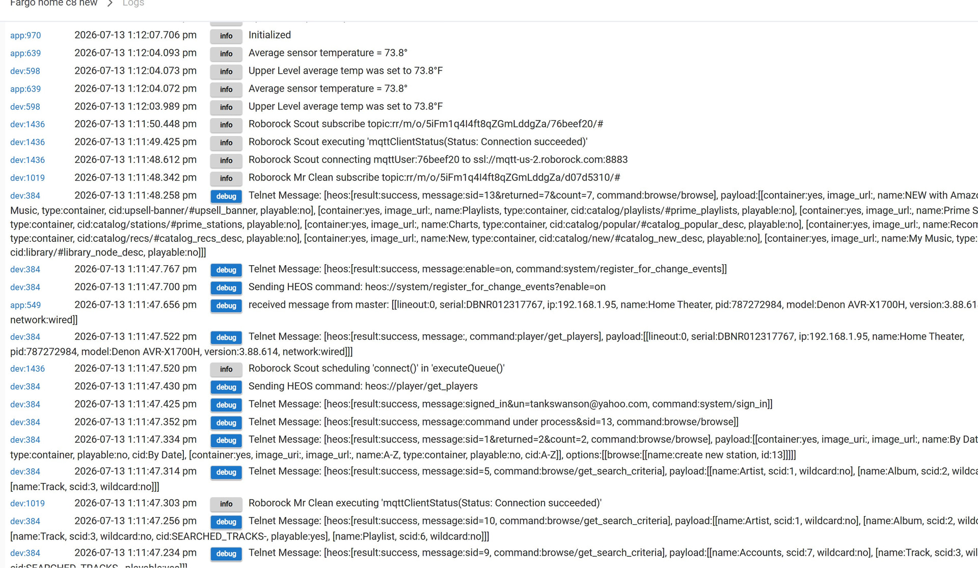

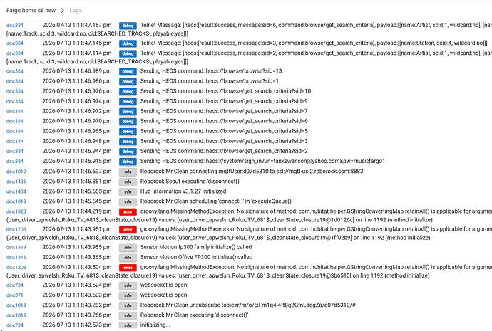

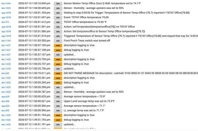

here are some snips of stuff from logs …. not sure the debug is an issue … but …

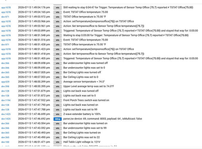

You need to look at the z-wave logs. Not the hub logs. Then copy/paste the logs into something like Gemini and/or Claude - they'll help you decode what the logs indicate and if the frequency of reporting is too high.
To get the z-wave logs, click on the "View logs" button on the z-wave settings page.
When you remove the physical controller from power it becomes a ghost. If anything tries to route through it will slow down. That’s why I would remove it when I removed ghosts that way.
Thanks Rick - i did a z-wave exclude and it’s gone. I rebooted after. That was a couple hrs ago … z-wave response on lights was ok after reboot, 4 shades and lock - iffy / not. Right now - lights are again non responsive …. here is most recent live log

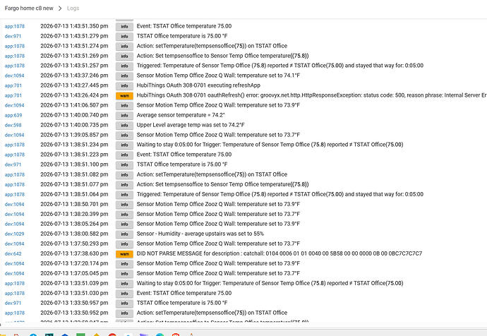

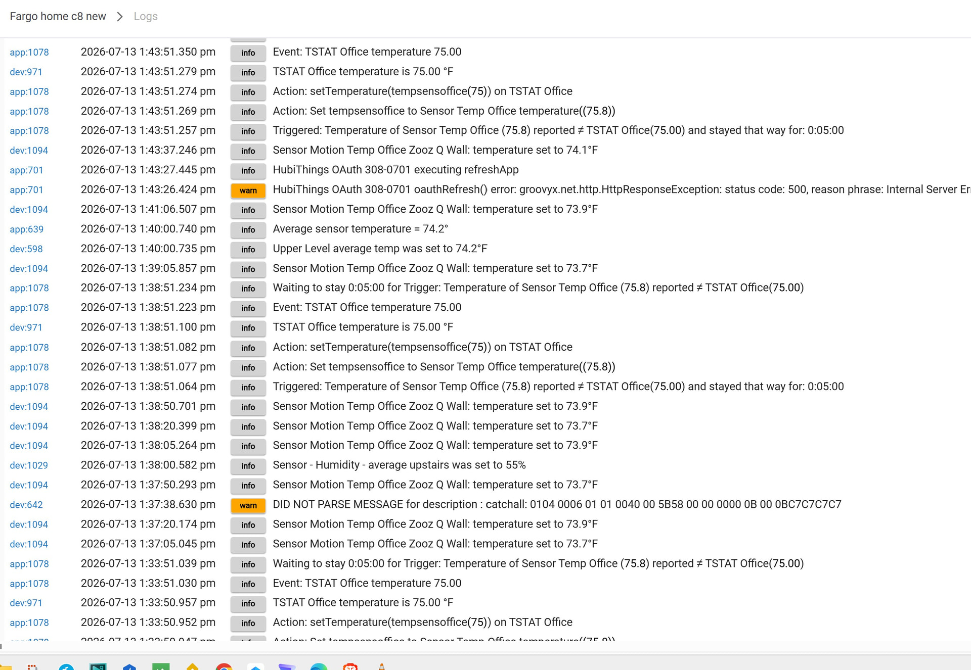

Did you capture those Z-wave logs like aaiyar said above? Let the hub run for a while with the Z-wave logging on, and preferably in a new tab or window. Copy and paste those into an AI assistant, and tell it that you are having slowdowns and lockups. Ask it to analyze those logs, and tell you if there is something that might be causing issues.
Take the AI statement with a grain of salt, but they can help to narrow things down. I had one spammy device on Zigbee, and it detected that for me. I wasn't having any obvious issues, I was just doing it as an experiment, but it truly found a device that I needed to tone down.
