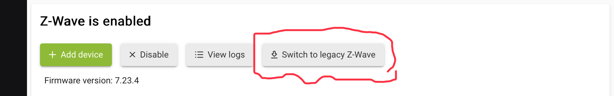

Welcome, since you have a C8pro you should be running ZWaveJS. You can verify in Zwave details:
Is ZWaveJS is running you will see this.
Once you’ve verified that, try clicking “Refresh” on one of the devices in the Zwave Details.
Keep trying SLOWLY and “Discover” should be replaced with “Remove”.
Be patient. If one doesn’t change try another.

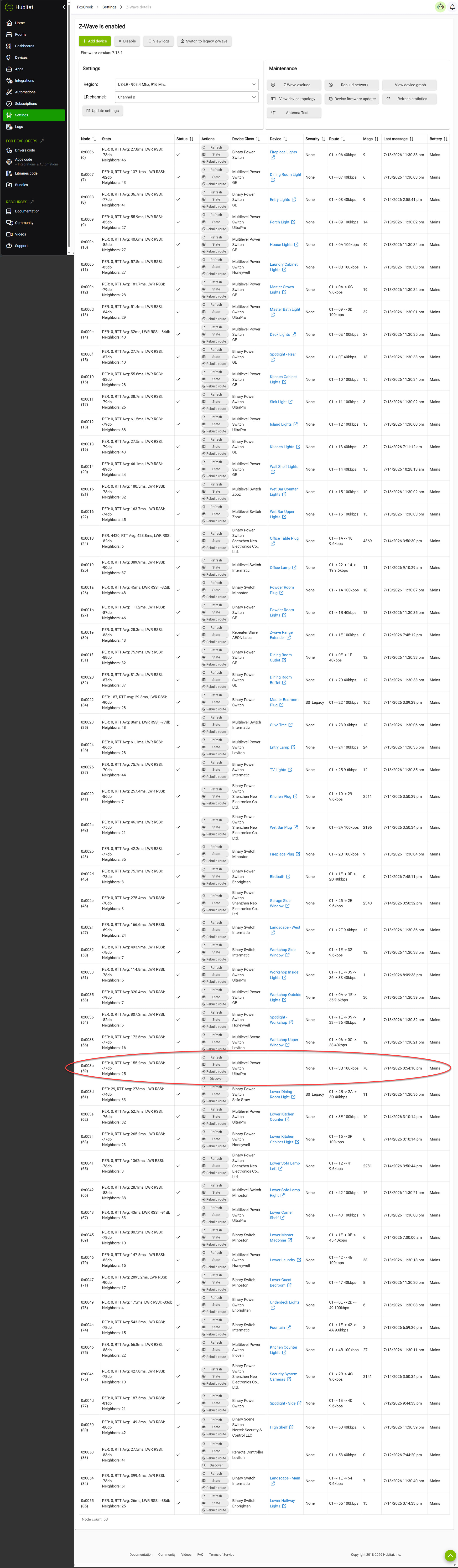

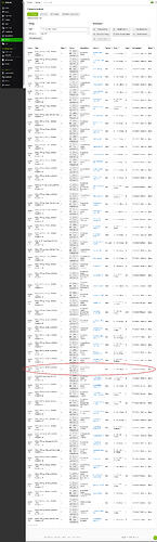

It’s pretty long but here it is. I’ve circled the device in question that has no name listed. All of my UltraPro switches are accounted for and working. I tried turning off power to all of them to see if the hub would then allow me to remove the entry, but no luck. Any suggestions are appreciated!
59 and 83 both need removed. Click refresh on those lines then click remove. If that doesn’t work, switch to z-wavejs, shutdown after reboot and unplug physical power for 1 minute. Power back up, wait 5 mins and try to remove again.
