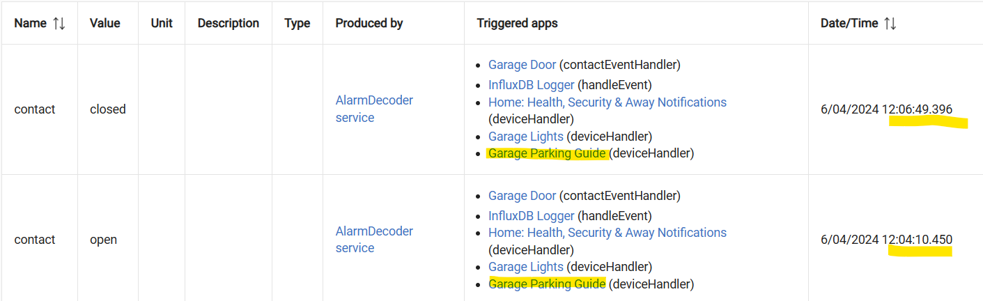

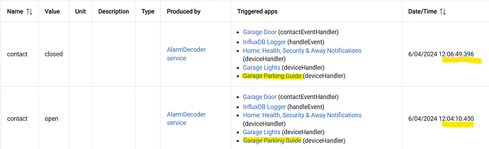

Here's the most recent example: The piston should have triggered twice, once when the garage door opened (12:04:10) and a second time when it closed (12:06:49). It only executed the second time:
From the triggering device:

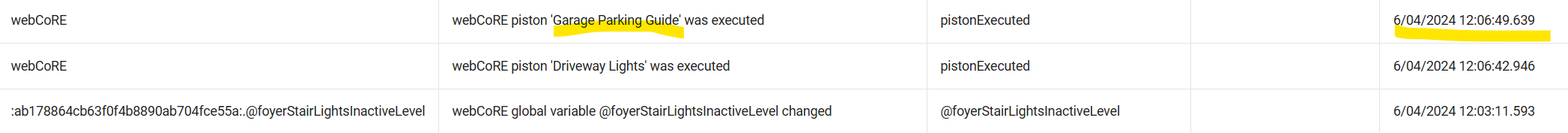

From location events (I have log piston executions enabled):
^^ note that the first event at 12:04:10 isn't logged (and the piston didn't execute)

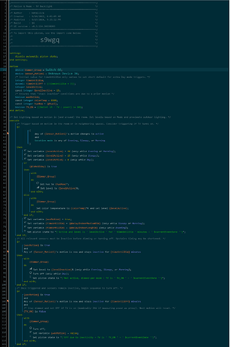

The piston itself is simple:
When I checked the piston execution time (in the WebCore dashboard), between these two events, it didn't show that it had executed either. I do see the event logged to InfluxDB, which is also triggered.

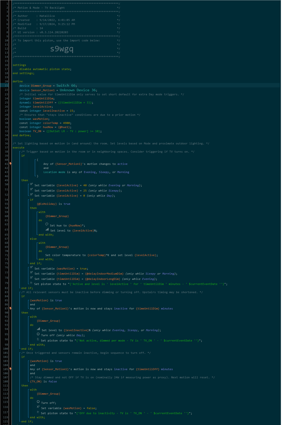

Anonymized snapshot of the piston for reference:
