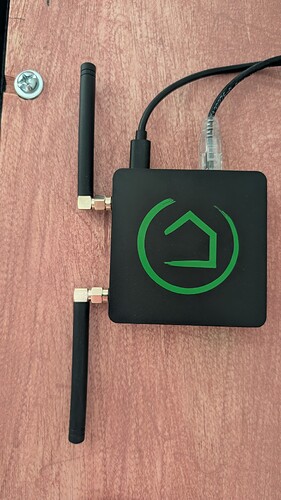

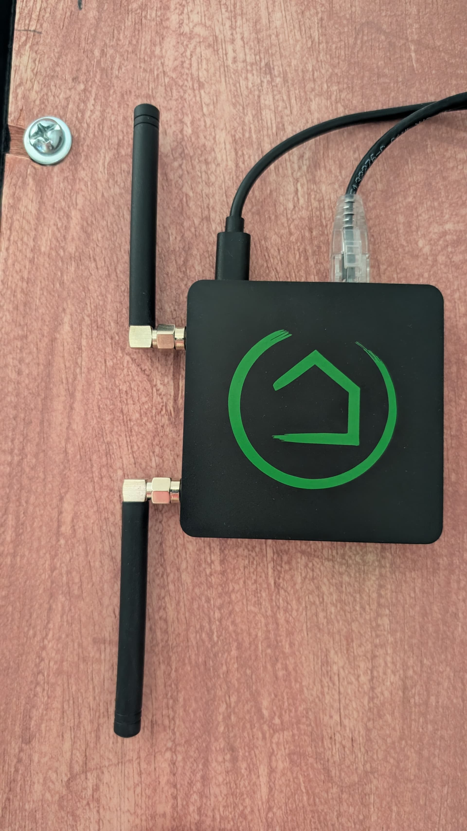

Which antenna is the Z-Wave one?
The one closest to the USB power port. If you are looking for a different z-wave antenna, I would recommend this one from L-com:
