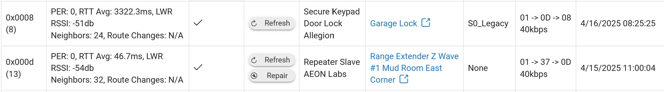

I am seeing odd behavior with my Schlage lock since my migration to ZWaveJS (4-Apr) which coincided with the upgrade to hub version 2.4.1.153 (from v2.4.1.131). I am using the system driver "Schlage BE468/BE469 Lock". I have been using this driver without issues, for years.
The symptom is that the locked/unlocked status within the driver does not update when the lock is commanded to lock/unlock via the driver. Though the lock does physically respond accurately to the command. Any manual turning of the deadbolt knob, or locking/unlocking via the lock's keypad, will cause a prompt and accurate update of the locked/unlocked status within the driver.
Please let me know if any logs would help to diagnose. I have included the zwave status here, as well of the status of the zwave repeater that is very near to the lock.
