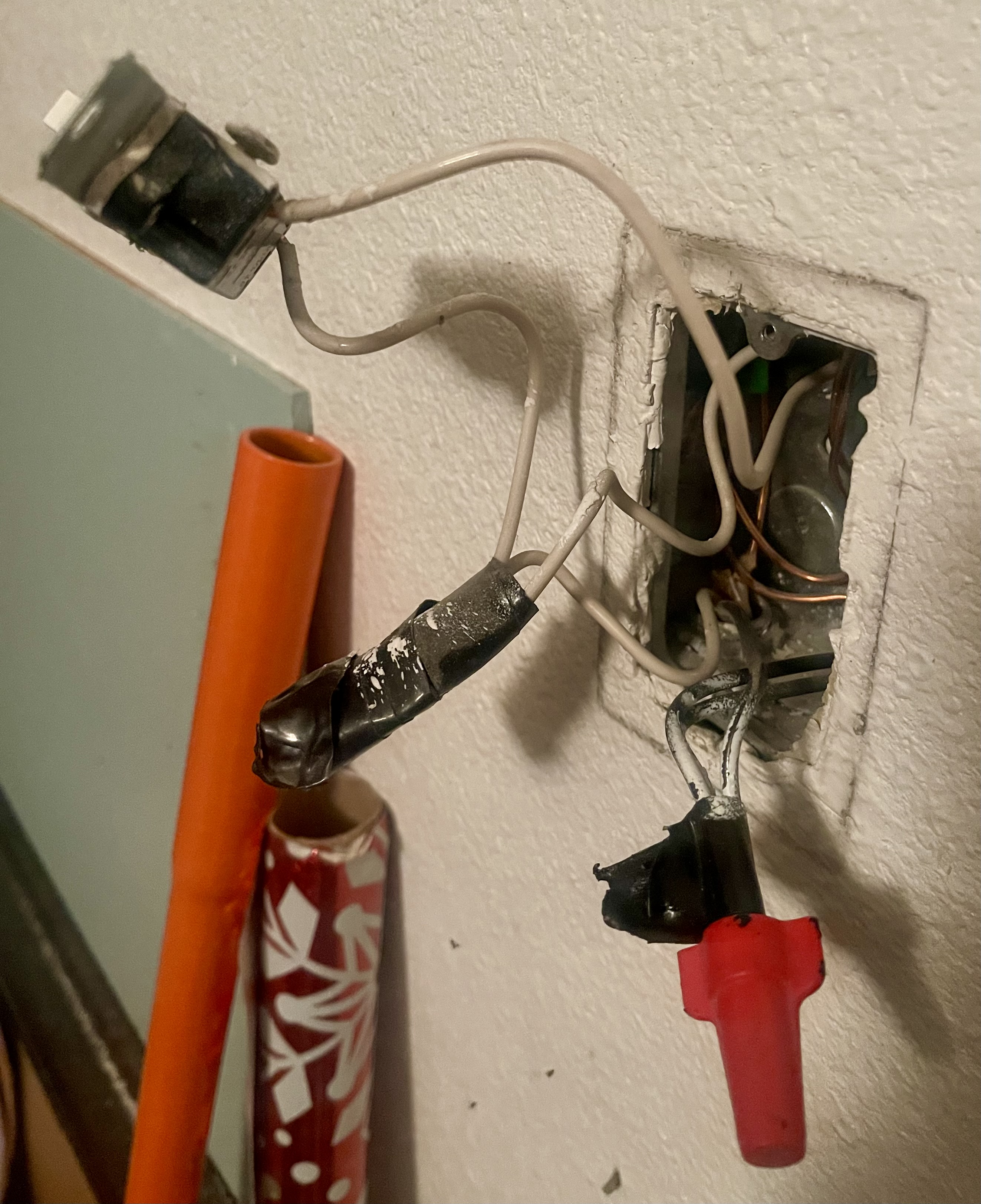

It may not be clear in that picture but the hot legs are tied together and the neutral is switched. :flushed:
The first thing I noticed was it looks like the Neutrals are just taped together without a proper connection. Then I noticed the back-stabbed neutrals on the switch.
There was a wire nut under all that tape. It's all sorted now with a fresh Inovelli Fan switch.

Wago's are fantastic. I've used them for decades. In this case I just used one of the existing wire nuts. On the hot side I have the incoming and the always on lead connected to the same lug on the Inovelli. The one going to the fan is connected to the load side. Then, since the wire nut was too tight I tied two neutral lines and a jumper with the wire nut and the other neutral and the jumper connected to the lug on the switch.
It is a shallow box so now I just need to stuff everything back in. That's another feature of this house. the wall is block and they framed it with 2x2's and sheetrock on each side so they didn't have to run electrical through the masonry. The house it built like a bunker and I don't hear anything from outside.

Fuuuuuu.... Man, you win the "found the worst wiring" challenge this week. Amazing what some people will do, and that they don't die.
Have you checked this with a meter? I’m not sure what’s going on with this mess, but I would not trust the wire colors to be correct. I have a lot of switch loops where the white wire is used (and not marked) as hot.
I would seriously consider replacing all of our receptacles in the house.
Unmarked wires, shoddy connections, and not to mention back-stabbed wires on old receptacles where the wire tends to pop out on its own over time.. these things cause electrical fires.
Swapping all the receptacles in your house is not expensive (unless you want to be fancy). You can get a contractor pack of outlets for $2-3 / outlet.
The reward will be in knowing that you mitigated one of the most common causes of electrical fires, at the cost of a few bucks and one Sunday afternoon.
How about where the switch literally breaks in half when you try to remove the back-stabbed wires, that's my house. All those switches are gone though, I replaced every single one with smart switches and new decora's on the other end of the 3-ways. I have a bunch of outlets I bought but have not replaced them yet.
Yikes. I've never had that happen, but I've had wires pop out when I pulled the receptacle towards me, gravity was the only thing keeping the hot wire in place. I've also uncovered more than one cracked electrical box in a wall with no insulation, so that fire would have plenty of air to travel. Scared me enough that I went and replaced all 70 switches and outlets in my house. The only two I haven't touched is the dishwasher and fridge.

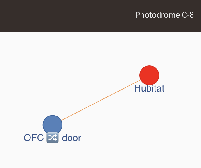

Unbelievable, I just added a C8pro and with no devices it is already in the red. :frowning:
