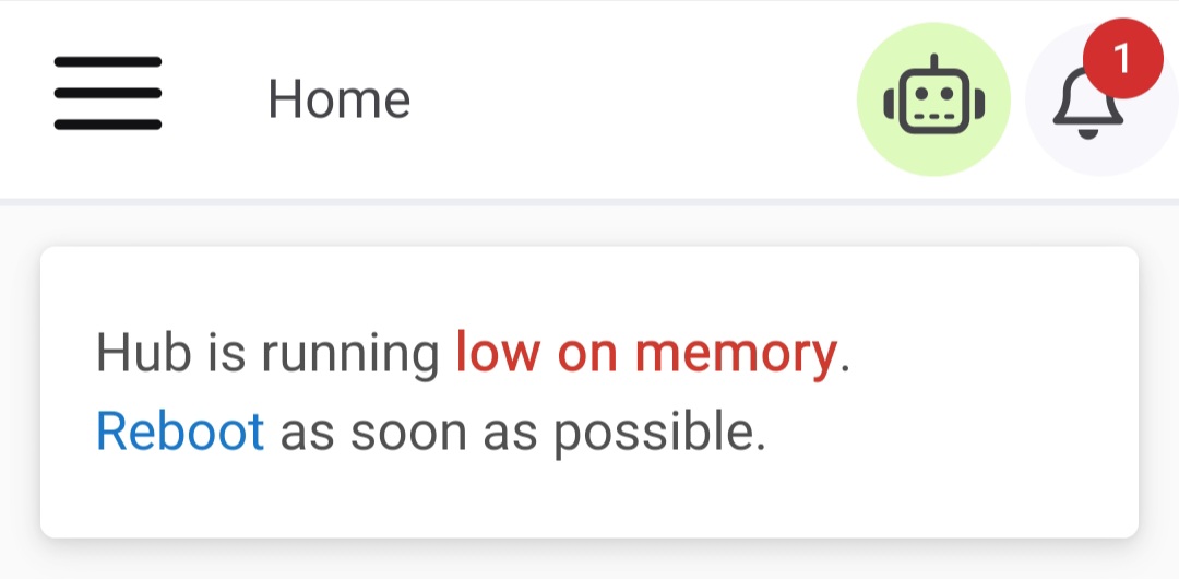

I’m getting low memory alerts from time to time, but the telemetry shows plenty of memory available on my hub C-8 v2.5.0.157 - this only started recently, any suggestions please?

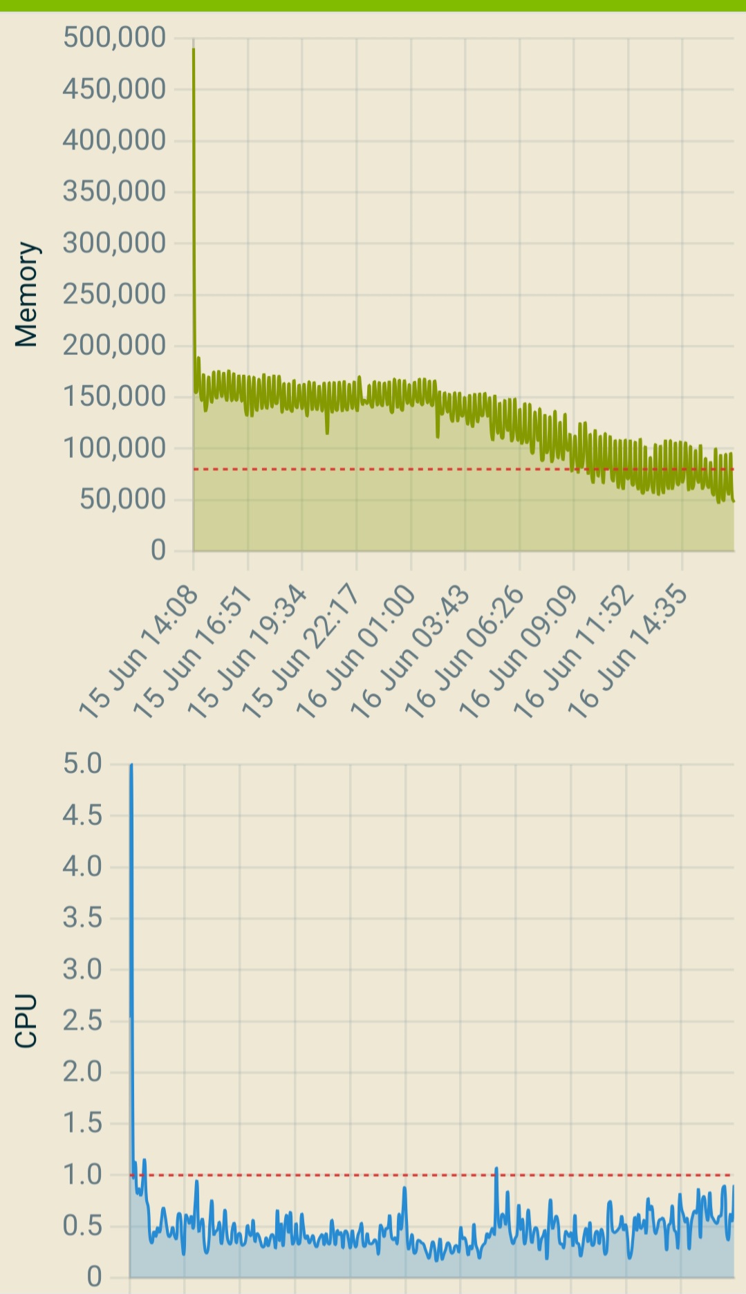

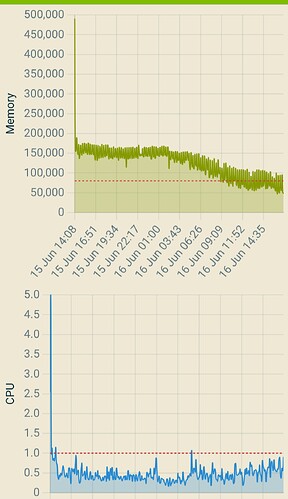

Well it is dropping below 100k. Probably due for a reboot. You can create a rule that at lets say 3am if the memory is below 100k it autoreboots.
Ah, so I'm reading the mem chart the wrong way? Assumed that was used memory, not free memory.

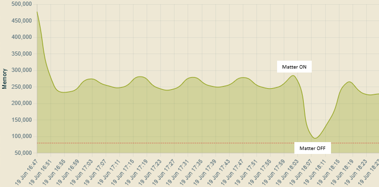

What caused it to go back up after turning matter off?
Investigating recent memory alerts led me to the free memory chart, troubleshooting then led me to discover that disabling Matter drastically frees up memory - what that chart shows is Matter being toggled on and off.
I have turned Matter off since I have alternative hubs to handle those devices, which has resolved my problem.

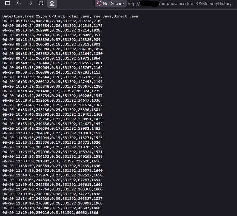

What’s the endpoint(?) for getting memory? This doesn’t seem to work anymore.
http://YOUR.HUB.IP/hub/advanced/freeOSMemoryHistory
With or without the History part.

Never mind, brain freeze. Helps to use the correct IP address.
Nice - cheers mate!
No worries. ![]()
